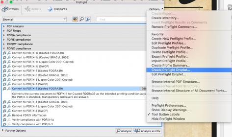

If you want to Preflight a PDF then Adobe Acrobat will allow you to save any Preflight (custom or default) as a Droplet App. (You can see the screen shot of the Preflight menu in Acrobat.
If you want to print, thats a different matter. Which App will be doing the printing? Acrobat? InDesign?
