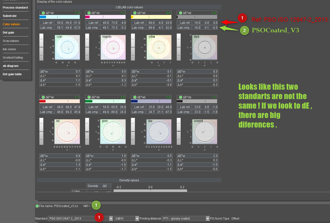

I am a bit suprise about this , because i tought they should match , but no .
If i compare the PSO 120647-2 to the icc profile PSOCoatedV3.icc we get this .

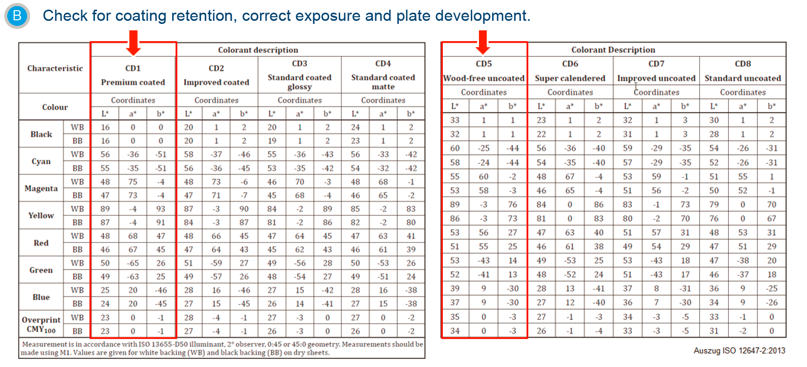

Where the ISO 12647-2_2013 have this values , this dE are not so high , but on color proofers or color reports we will get problems . Because the Lab targets are not ISO 12647-2 2013 .
What standard should i use to generate color certificates ?
Who rules here ? PSO Coated 2013 or Fogra 51 !
