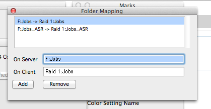

We just switched our Server/Nexus RIP PC to a New Mac Pro Server/Rip 10.1
In our Artpro applications, under picture menu, folder mapping, we used to have F:Jobs Raid1:Jobs to tell apps to look for links there.
Now we have a Mac Server/Nexus rip and I do not know how to direct applications to go here for links.
Anyone running a Mac for their server and Nexus RIP?
What is in your folder mapping?
Thank you.

The Nexus RIP is running on a Windows box? If so, the Nexus RIP PC is likely accessing your Mac Server via SMB. Check your Oplocks in the SMB config page. Also make sure you have proper ACLs configured for any Mac clients.
Beyond that, I'd prolly need more about how the Nexus RIP works. How it accesses the server.
I also have no experience with a Nexus Rip, but can only assume you have tried the obvious - click the add button, see if it will let you navigate to the location (you would have to set one up if the Nexus install hasn't done it) where you want these files? Permissions may well come into it, but I would not be surprised if the Nexus install didn't take care of that? Or maybe not.

You don't need folder mappings.The Folder mapping is only when the mount points are different for clients vs RIP.
When you mount a volume on the client.. "Jobs" it will mount the volume on your mac as /Volumes/Jobs/
When you mount the volume on the Mac Rip it does the same thing..
