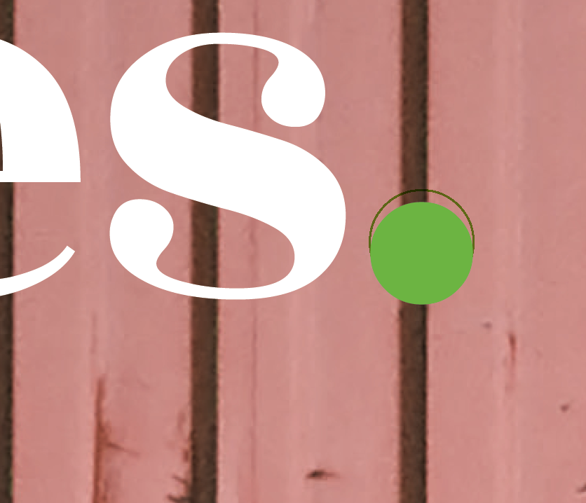

Has anyone else seen anything like this?

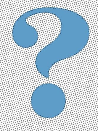

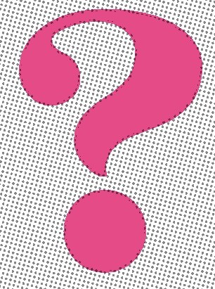

A client recently started using a new font in a multitude of projects, and subsequently is driving us nuts.
It consistently produces traps that are misaligned. (see images)
Font is "RozhaOne-Regular.ttf"
Punctuation characters seem especially susceptible, though text can have the same problem, depending on the character. (loopy things, like lower case g, for example)
Working on a MAC
Running Sierra 10.12.6
Prinergy Workshop v. 8.1.2.342
Our solution thus far has been outlining the fonts in our Input PDF. Easy enough to do for one client, but I would love to know what the heck it's all about.

Assuming that the trapping irregularity appears only when you pass it through the Prinergy code (correct?), maybe the best thing to do is to contact Kodak Support as see what analysis they can do with this.
The problem may be with the TrueType hinting in the font itself, the Prinergy software, or the combination of the two.
The last thing you want to be doing is “outlining text” since that destroys hinting, generally degrades quality, and has other PDF side effects you really want.
- Dov
Yep...Google font or any web font. Freeware fonts too. Prinergy does not work well with any of those types of fonts.
Hopefully you have reported this to Kodak. When you say “web font” what you are really saying in this context is TrueType fonts. It sounds like Prinergy may have problems with its proprietary trapping and the hinting in some TrueType fonts.
- Dov
Usually I trace it back to either a Google Font or a freeware font. I say web font because that is usually a Google font but there are others besides Google. Also some Microsoft fonts like the ones included with Windows/Office. One sure fire fail is Roboto. With freeware fonts many times the file will fail processing in the trapper with the error that the font does not have a license to either embed or outline the font. Prinergy does not actually embed or outline any fonts in the trapper but it has to be able to perform those functions to create the trap. And yes they have been reported to Kodak.

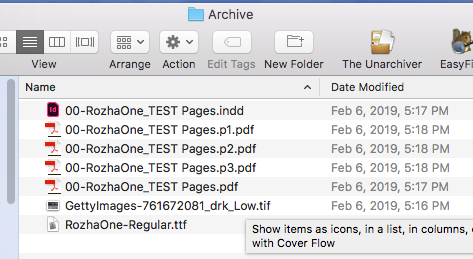

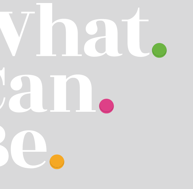

I made some test pages. I tried to illustrate the range of content involved in one f the jobs.
Indesign file, Font, 1 link, Input PDF, and the three refined and trapped result pages.

As someone mentioned upthread....RozhaOne is a Google font. Kodak will tell you to tell your customers not to use Google fonts. I ran it through Prinergy 8.2 and got the same results you got. Misaligned traps. Google fonts were made for using on websites. Not in print production.

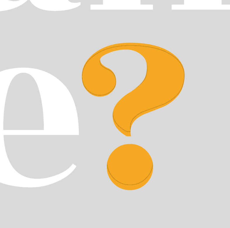

I started with your PDF and got the same thing you did (it appears the PDF files are pre-trapped). So...
I made a new PDF of page 1 from your InDesign file and did not convert the spot colors to process. Here is what I got in my Apogee system with our standard trap settings:
Looks like Apogee doesn't muck it up like Prinergy.
The PDFs with the "p1, p2, p3" are the trapped files from Prinergy, (and converted to 4c.)
The "00-RozhaOne_TEST Pages.pdf" is the input file and isn't trapped or converted.
I noticed when working in Prinergy for several years that the updates were giving different (Bad) trapping results. We found the centers of "O"s and "A"s were not trapping as expected (no trap at all). This may be rumor but at one point the trapping engine for Prinergy license was lost and Kodak had to rebuild from the ground up. I don't work in Prinergy any longer and don't miss the headaches we encountered with trapping in their software.
Actually, this is true. Heidelberg co programed Prinergy with Creo. The trapping engine was one of the many programs that were Heidelberg’s. Creo ended up buying Scitex, which was a direct competitor of Heidelberg Prepress. The joint venture was dissolved and Heidelberg started to work on a new workflow. Mind you we still had Signa Station, MetaDimension, Supertrap (this was a standalone version of our trapping engine in Prinergy, it was an Acrobat plug in and won a GATF Intertech award). In 2003, we launch Printready , which evolved into the present day Prepress Manager. After a certain amount of time, Prinergy was no longer allowed to license the Heidelberg programs, one being the trapping engine. At that time, Kodak had bought Creo and had to develop their own trapping engine. If you look at Prepress Manager, most of the sw is Heidelberg coded programs. As another example, the preflight engine is ours and has been around in one form or another prior to 2003. By the way, we are currently on Version 21.

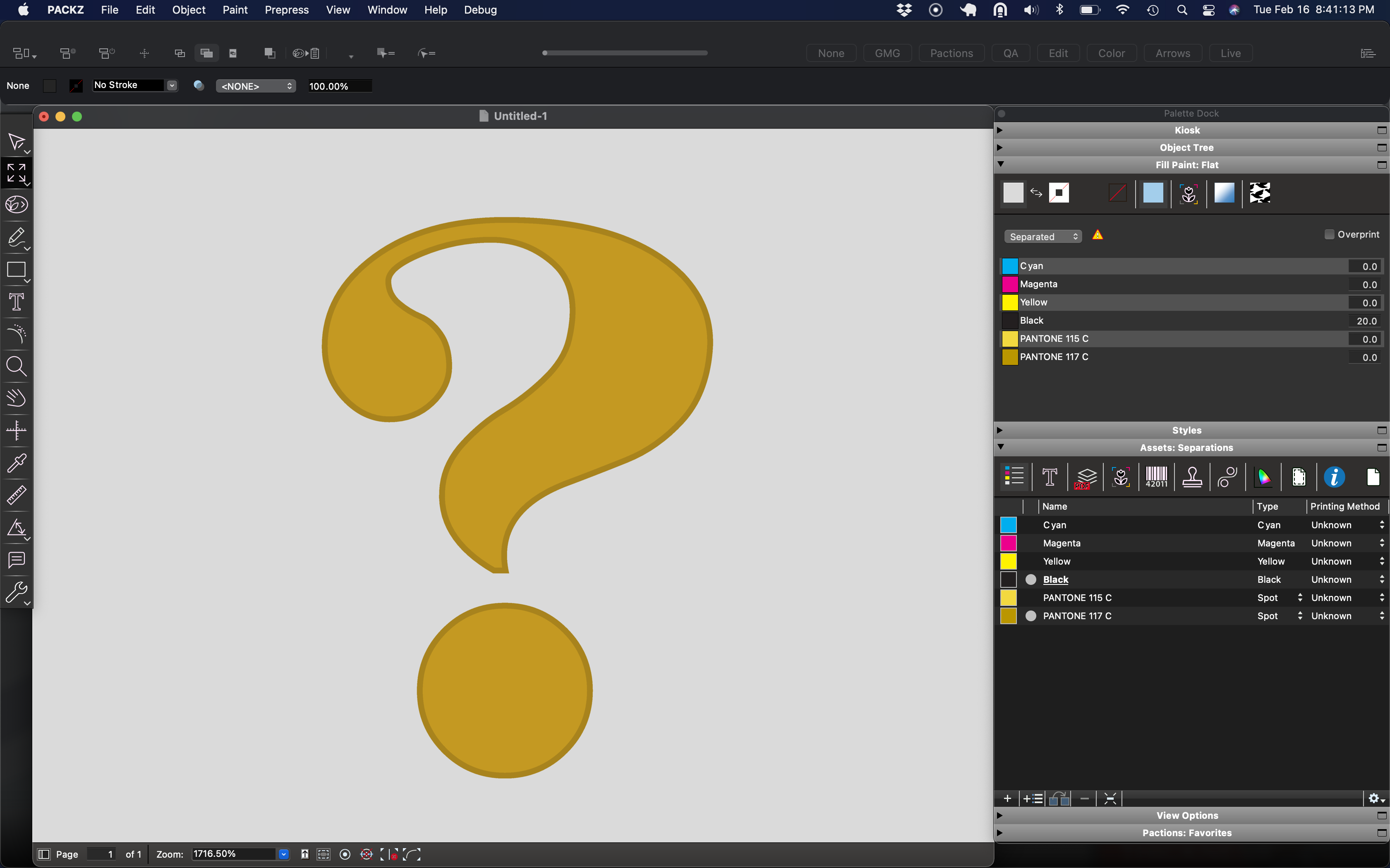

Have you thought about getting a PDF editor like Hybrid Software PACKZ? I recreated your file and trapped it. The results are great in PACKZ.
