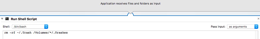

I searched for a terminal command to force empty the trash and I found the command as detailed in the attached image. It might be overkill, but it works…sort of:
This empties the trash OK, however it always pops up an error message that needs an OK (The action run shell script encountered an error). I am guessing that I have not setup my Automator application correctly, the command works but I would like to not have an error message requiring an OK.
Any ideas on how to fix this up?

You can create an AppleScript, then compile it as a Run Only app. Here's the code:
tell application "Finder"
do shell script "sudo rm -rf ~/.Trash/*" user name "Administrative User Name Here" password "Administrative Password here" with administrator privileges
end tell
Cheers,
pd
Fantastic, thank you – that works great!
