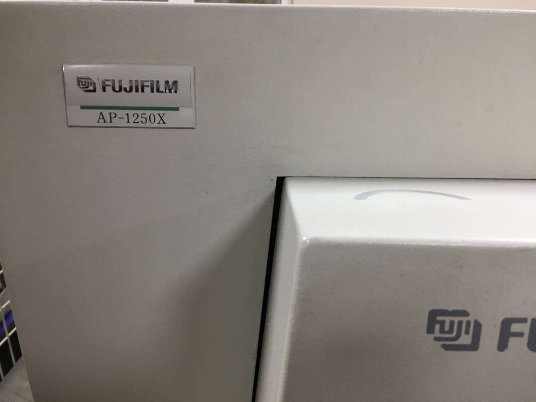

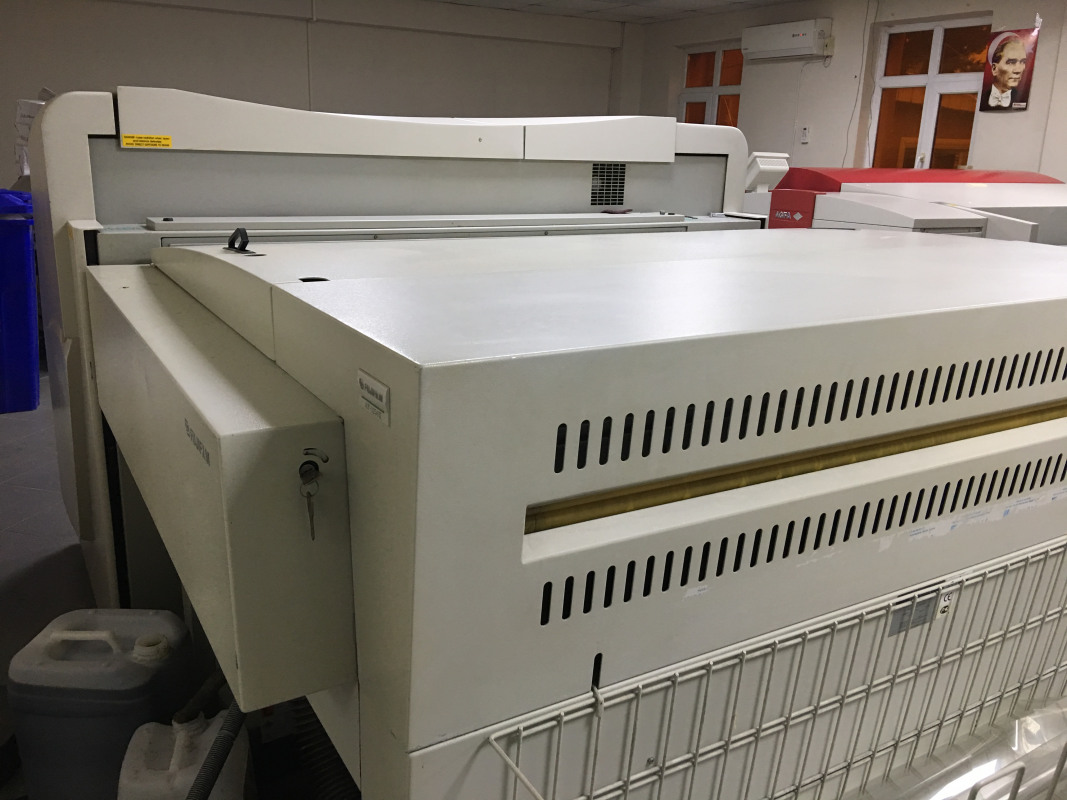

has anyone have service manual for FUJI AP-1250X machine ?. I had one second hand machine but does not work properly. So I need manual for guide hoe to check.
