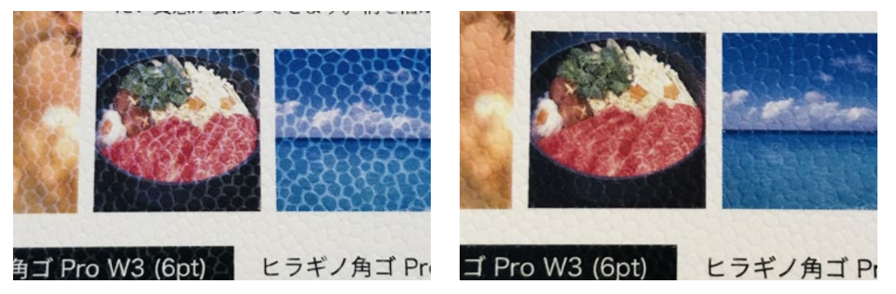

The Texture (TX) toner is used with textured papers that have rough/uneven surfaces. Without the TX toner, the printing would be uneven and spotty in sections where the toner cannot cover evenly the surface of the paper.
The TX module/cartridge can only be used in the overlay (position on the right). You will need to make special paper print settings for those papers that will use TX toner. When you use TX toner you won't be charged (you shouldn't be charged) as a specialty color, because it aids the CMYK printing. Wherever you print CMYK, TX will also print in the same spot when the setting is turned on. This is why it's not charged like a specialty color.
I'm attaching an image, the left side is printing without TX. The right side is printing with TX.
In Japan this paper is like a crocodile skin, so it's very textured and uneven.

Hi Aleksandar,

thank you verry much, i appreciate you took your time to write detailed explanation, now its much clearer. I thought that for embossed papers its enough to put in paper stock that its embossed, and i also printed on those papers with no problems, when i finish adjusting image transfer it looks great (to get the right amount of power on that kind of paper). But i guess with really complicated and deep embossed paper this is must have option, the TX toner. Didnt had really much of structured papers for print.

Some embossed papers print fine without the TX toner. It's the really embossed ones that don't always print well. For those papers TX is very effective! Because we use lots of different textured papers, we've made individual settings for each on the profile database.
For using TX there are specific settings in the print server. Unfortunately we don't use Fiery in Japan, Fujifilm has their own software which is used domestically. But, give me about 9 hours and I'll take some pictures/translate the settings and send a reply from work tomorrow.
