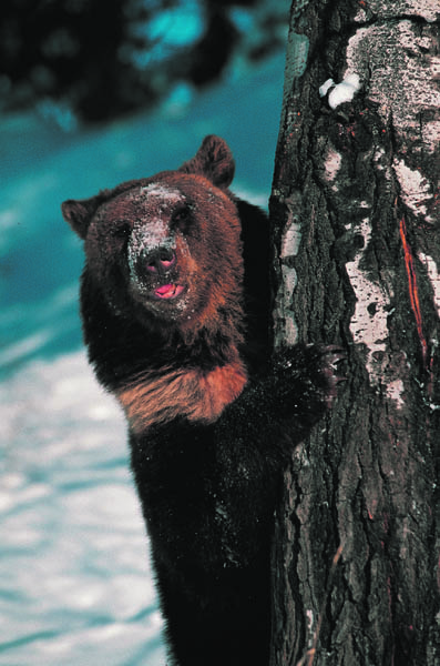

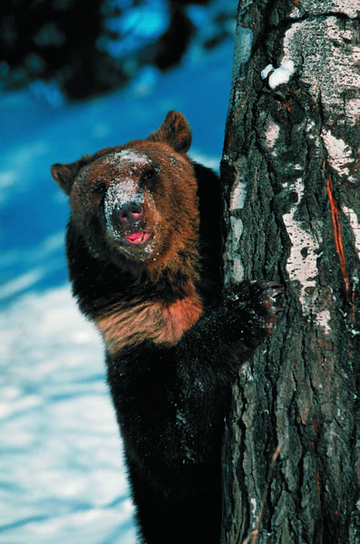

Here is a great example of GCR - open these images in Photoshop and look at each color side by side. . .

Thanks. Which is more near to the original? UCR or GCR? Do you have the original to compare to see if colors have changed compared to the original? Just wondering if GCR should be avoided totally if the colours are changing substantially?
danremaley
In Photoshop, some colors do change a little (depends on the color) - less change from dedicated software. In either case, there will be less variation in color during the press run than a traditional or UCR scan.
