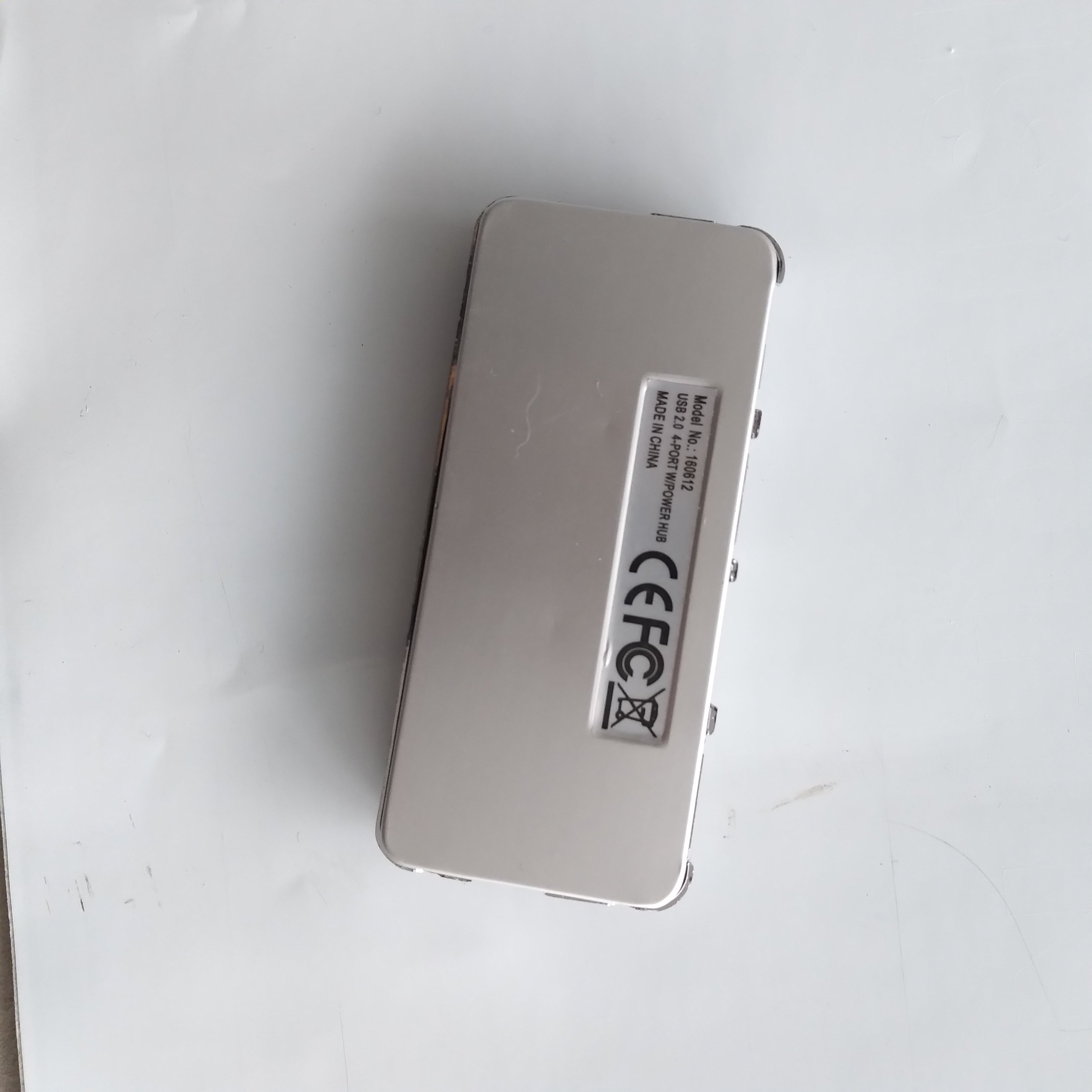

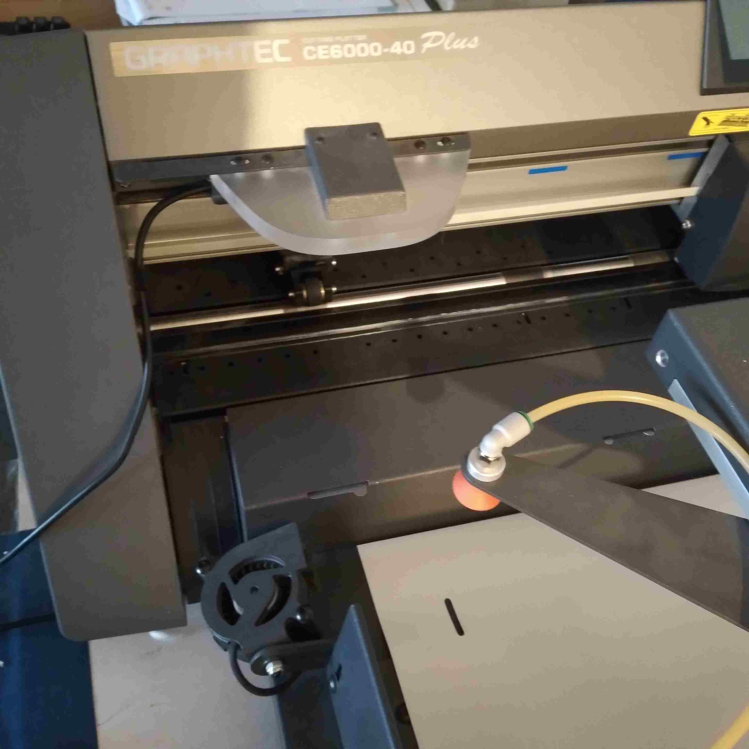

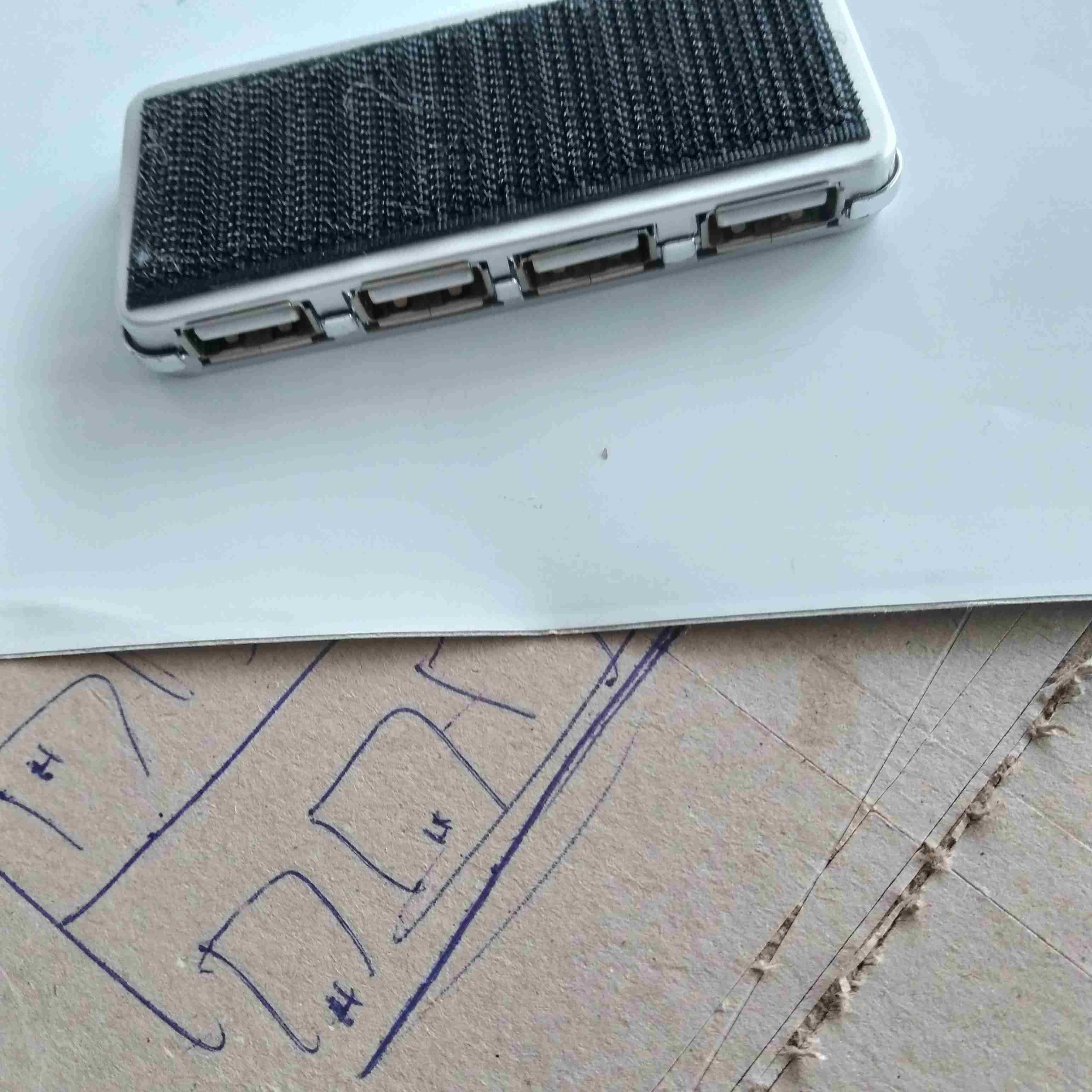

I have an older model F-mark. CE6000-40 Plus. It has died. Camara still works fine, Cutter works ok. Just not the arms. (the F-mark bit). There is only one agent in this part of the world for these.
Got the tech out and he suspects the hub (which seems strange to me as it's so simple) see photos 1-3. The long and the short of it is, they want to sell me a new Graphtec hub (over $500). With no right or return if it's not the hub. there's customer service for you
I have obviously tried other hubs (no luck). Business has been quite lately, and I cant afford throw $500.00 away. Unfortunately, I don't know anyone with another one of these.
Any thoughts? if there is someone in this part of the world (New Zealand) with a hub as per the photos? I can make it worth your while. I'd even look at buying a complete machine (for the right price).
Any help appreciated.
thanks Simon

I call BS on the 'HUB' being machine specific.
Hi Chris. Yes I tend to agree with you. Which of course means there is something else wrong. It could be something as simple as a software conflict. Update conflict? All though I have tried running it on an old PC (not online) in case this is the issue. ta Simon

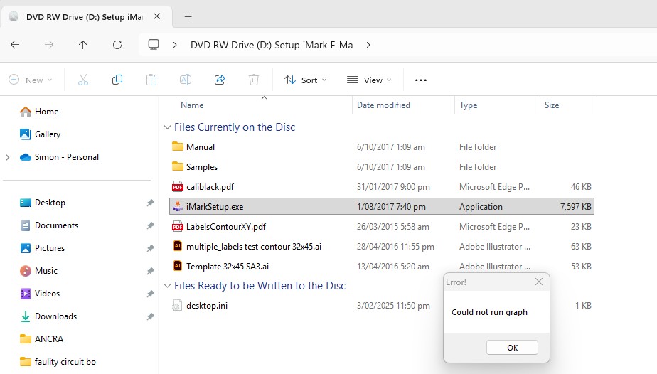

Hi there.
Re F-mark.
Just trying to trouble shoot this with my limited skills. I have uninstalled and reinstalled software. Getting this coming up. "could not run graph" See screenshot. Currently trying on windows 11. Maybe this is the issue? (need an older OS?)
Once I get past this! I can't get the cutter online. "Cutter off line ! " Driving me nuts.
ta Simon
