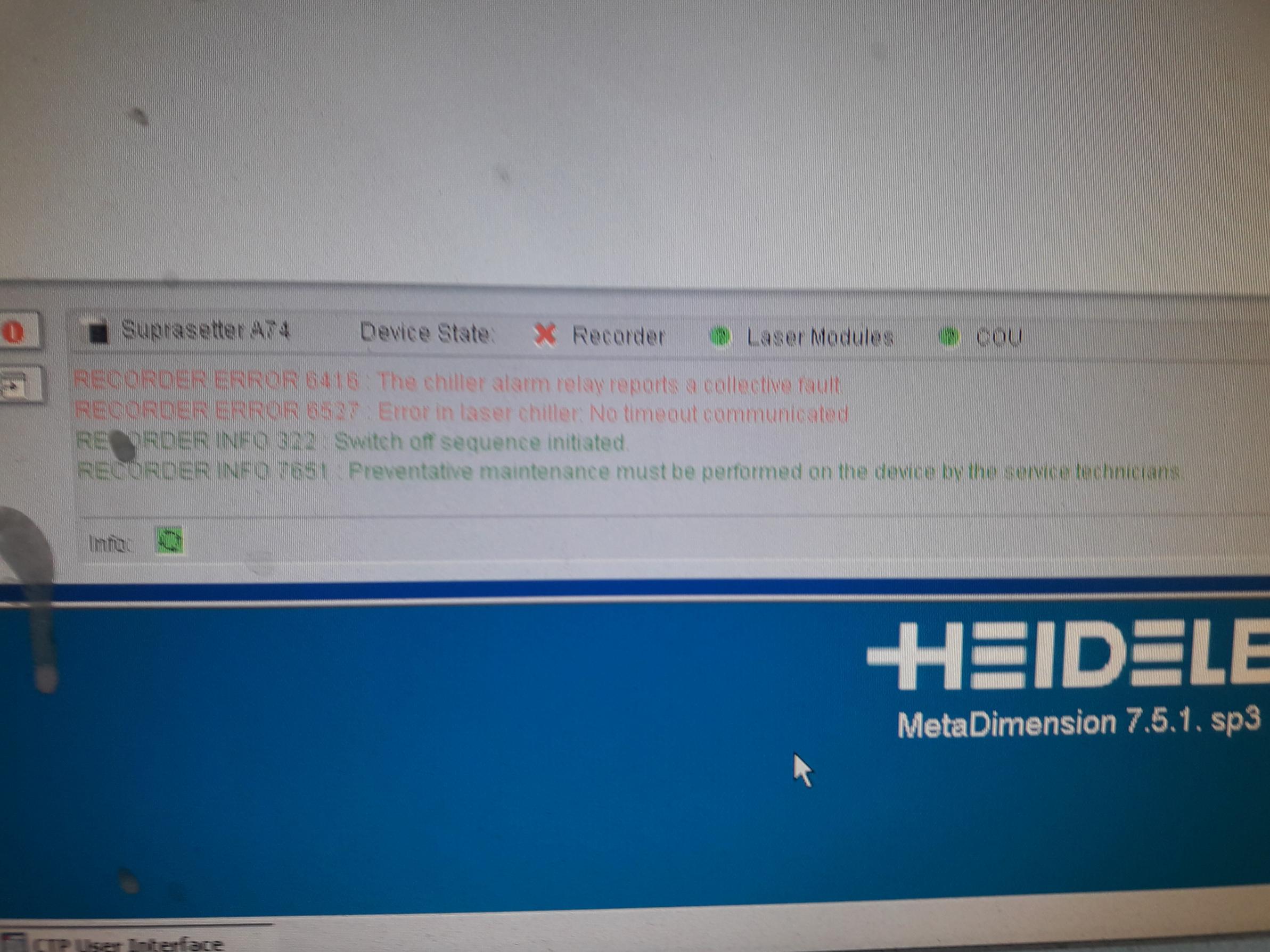

Hi every!
Have a prublem with Suprasetter A74. When startup - CTP user interface gives folloving messages:
The chiller alarm relay reports a collective fault
Error in laser chiller: No timeout communicated
And Suprasetter don't starts.
Did anybody have the same trouble?
No Title
The chiller is full and all cables is connected !
Hello
No need to replace the pump. The problem comes from the board of the chiller. It has a serial communication chip and only to change it.
