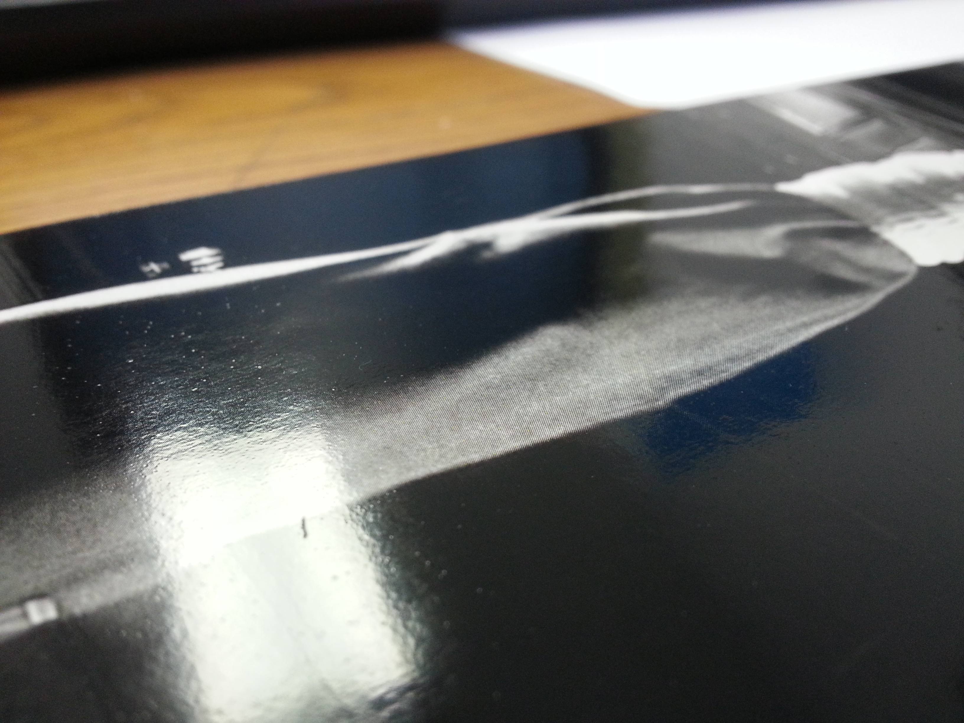

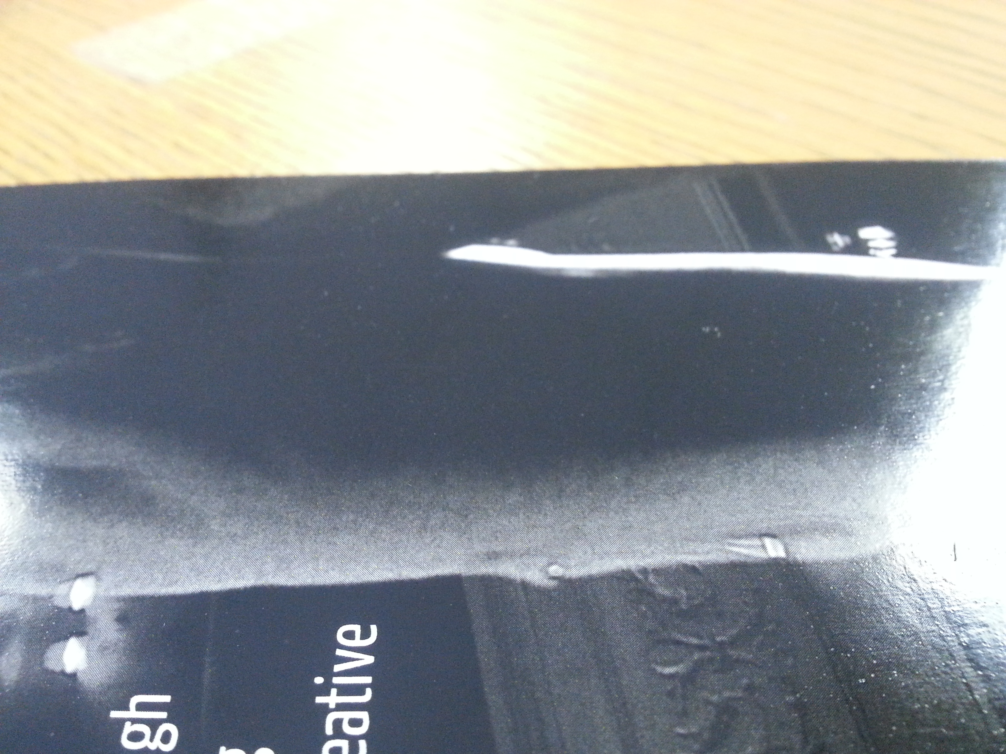

pdan, we looked into that. Vacuumed and blew out entire press. That didn't work. Here are some pictures of what's happening. Thanks for helping.

What type of digital machine are you using? Have you only been having this issue with a single substrate? The reason I ask this is it may be possible that it's paper dust that's inside maybe before the fuser or even afterwards at some of the points where the paper makes a sharp turn and gets put back on top of the toner. When are you wiping each sheet down? Are these being finished by anything other than your coater before or after you wipe each sheet down?
Eliminating variables will eventually let you know where the problem lies.
