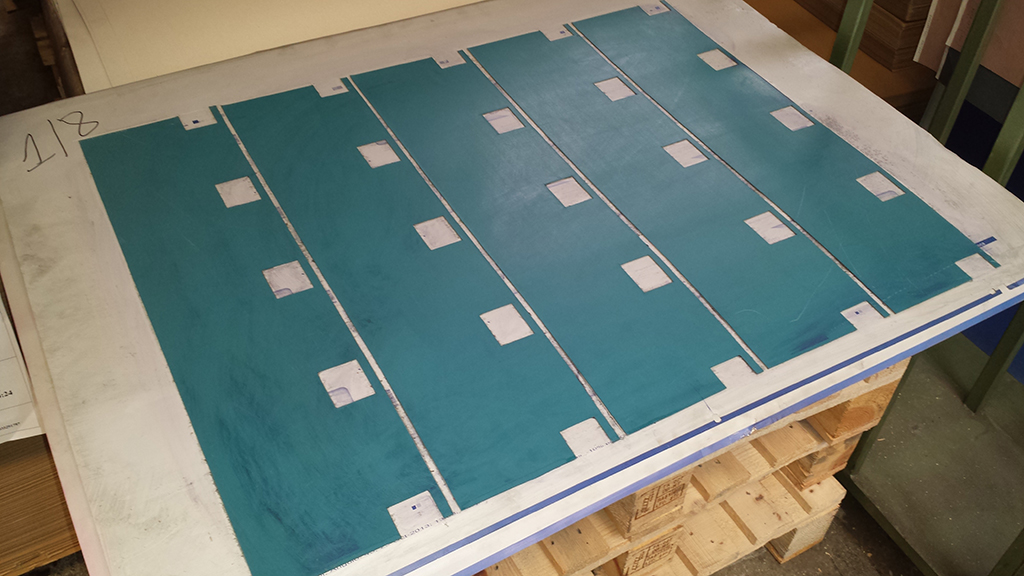

But with that blanket, we need to then paste above one ctp plate, so the blanket can enter inside the offset machine, and the plate. See the attachment below to understand what I'm saying.
Okay, so you say that is possible. But, should I cut the blanket without pasted into plate, or cut the blanket together with plate.
What we do at the moment is just, place the blanket into plate, and then put into offset so the offset will print the job into blanket, then when we can see the job, we cut the holes and things that need to be cutted.

It looks from your picture, that you are using a "sticky-back" plate material, then mounting it to aluminum plates, back printing the image on press and then cutting our your coating patterns - the same procedure recommended in our KBA press manuals. We had done this in the past, but are now cutting on a Kongsberg table. When we used the sticky-back material, we mounted it to the aluminum plate first then cut the pattern on the table. Word of caution....aluminum does not like to be scored and as much as we adjusted the knife height, we almost always got some sort of scoring on the aluminum - which then of course makes a very weak area for the blanket to come apart on press. We ended up switching to folacoat blankets as scoring the mylar backing is far more forgiving than the aluminum. Cost for us was pretty similar and in my opinion, the folacoat blankets do put a nicer/smoother layer of coating on our sheets.
