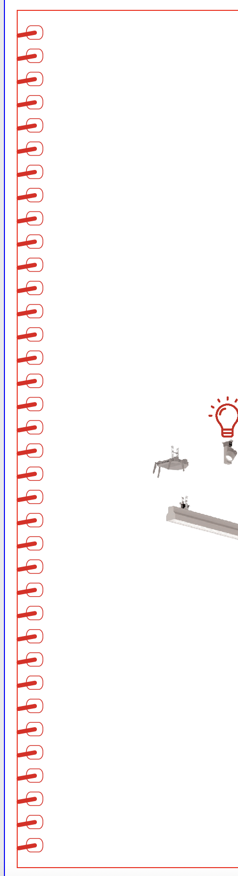

Pitstop might be an option as well, depending on budget. You can write scripts to alter the bleed size, add non-printing FPO graphics for spiral binding, change page sizes, etc. It's pretty powerful.
