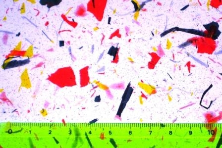

I had not seen that earlier, still a late reply: Even if it would work in an "expensive" process, it would have to be kept separate (by labelling it?) and only directed into that special process; standard mills do have a severe problem and carefully avoid it by checking the incoming waste paper. "Downgrading" for packaging (corrugated) is still possible. Again, for that it must be kept separate from other graphic paper for recycling.

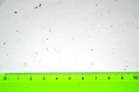

And that Indigo forms a film can be seen if you try to dissolve printed pages in water. The fibers go into the water, leaving large and very thin particles, and these cannot be removed sufficiently in the paper recycling process. The ruler is in centimeters:
Indigo prints in the lab (undeinked) - Indigo prints in the lab (undeinked)Indigo prints in the lab (deinked) - Indigo prints in the lab (deinked)
