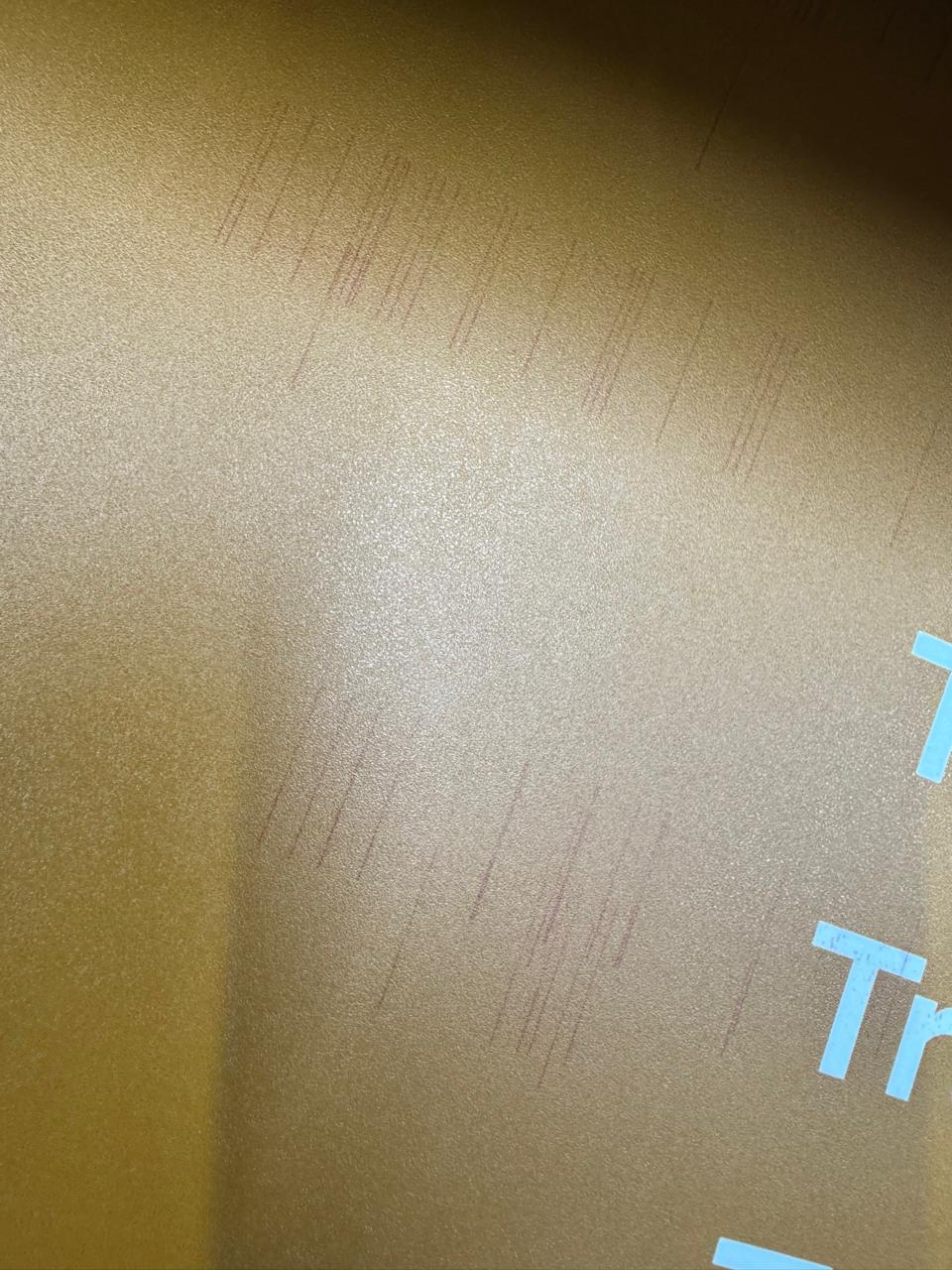

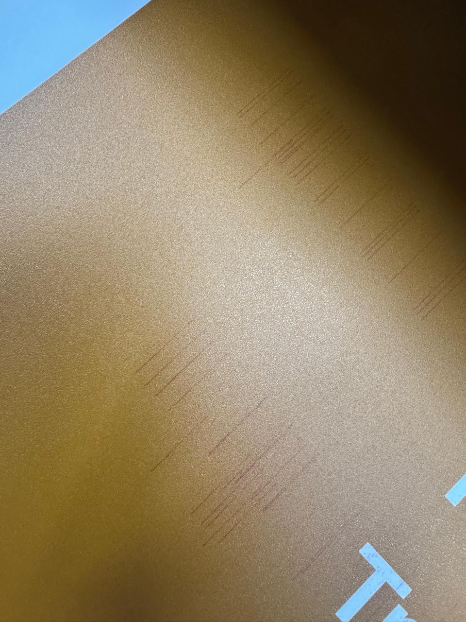

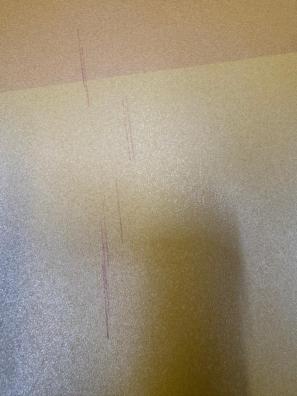

HP latex 570 red lines on print
ronnyadonis
these lines keep appearing out of no where. Looks like a scrape but it actually gets printed on the files. Changed all heads to brand new, still no luck. seem to be happening only on the center part of printer just after 70cm from right. If i print anything less than that size and shift print to all way right all is well. Anything bigger and exceeds that width and is near center this is coming. Any help much appreciated. Thanks
I had something similar to this on my z9pro. It was the trailing cable that had partially disconnected itself and once it was reseated at both ends its been spot on since.
Cheers
Chris
