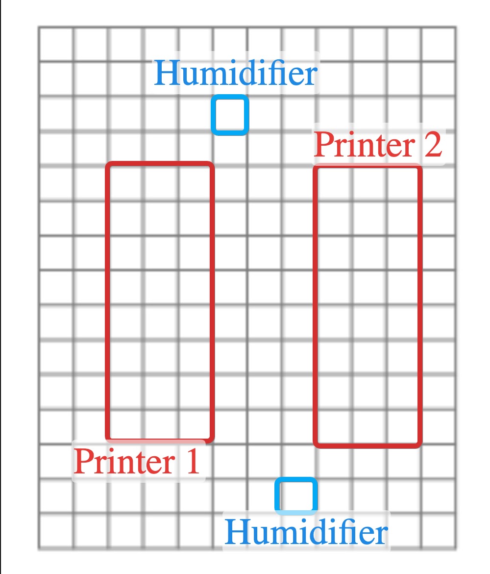

1 more question are you placing these behind the machines or just general location

We run 2 of the models I pictured, set up kind of like this:
Works fairly well for us - but we're just trying to raise the RH to a minimum of 40%, we aren't targeting anything higher nor attempting to maintain a steady RH...we're mostly looking to ensure that our repair techs can't just blame humidity when they need to replace parts lol.
