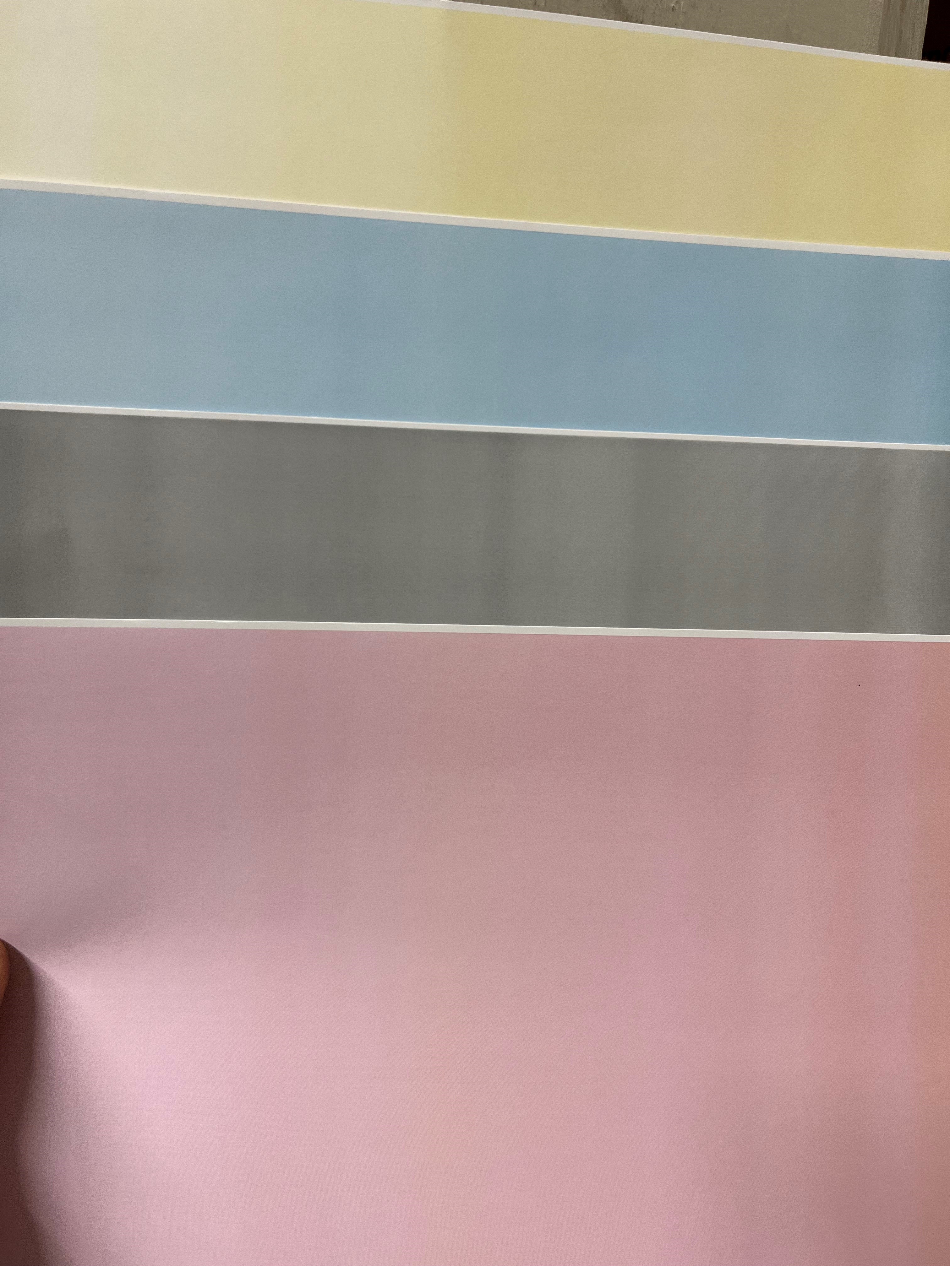

We've had the Iridesse since 1/1/22. Recently (in the past 6 weeks) we've been seeing light/dark streaks in our prints (see attachment). Our techs have said it's the charge wires, and replacing them with new immediately resolves the problem. However, we are needing to replace them much sooner (1 week instead of one month). The tech also said he's not seen this problem at any other machine sites. This makes me think it's something environmental. I have been running a cool mist humidifier in the wide open room, mainly for other equipment, and the humidity level at the Iridesse is currently at 37%. This issue was not present at this time last year. Any ideas on what the cause might be?

I would have agreed with checking your humidity. But as you’ve done that - 37% is decent this time of year - if replacing the wires fixes the issue (temporarily) then it must be something with the wires right? I don’t have an Iridesse, but there’s got to be some automatic or manual cleaning routine you can run right?
I feel like maybe this could be a filtration issue in the machine, but again not knowing the Iridesse - are you able to check if the machine is due for filters, or examine them to make sure they are in place and or not clogged?
If you’re able to change the wires yourself, maybe the tech will let you keep some on hand to cut down on service calls. If it’s a constant issue the tech “hasn’t seen elsewhere” and isn’t able to resolve, I’d be shouting for a service engineer to visit.
Thanks @kslight. The regular tech is one we've known for a long time and have a lot of trust in. He's as eager to resolve this as we are. We do have spare wires on hand and can change them ourselves. They are included in our maintenance contract as parts, so if too many of them get used, Xerox themselves may escalate the issue to someone higher up in service.

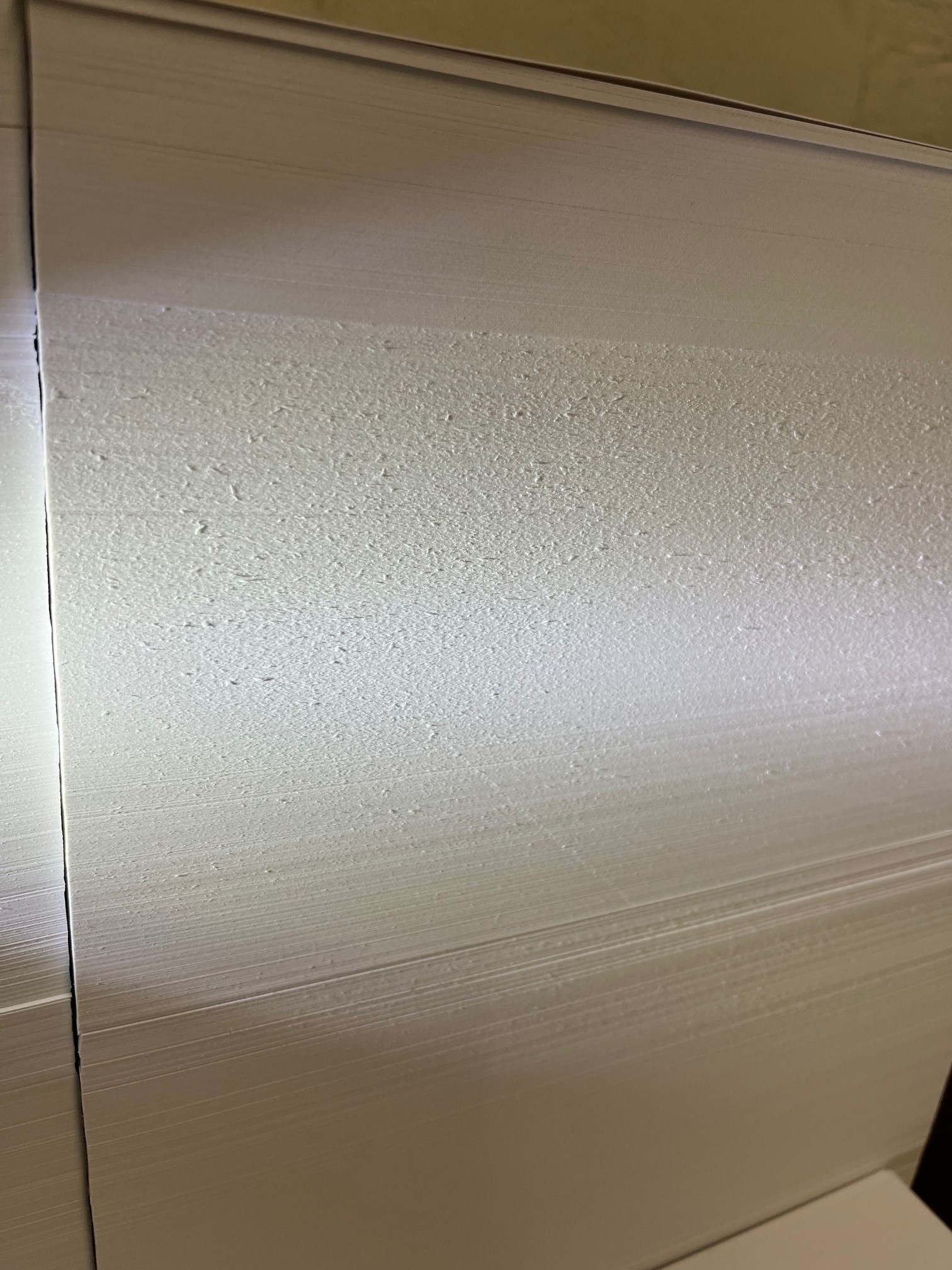

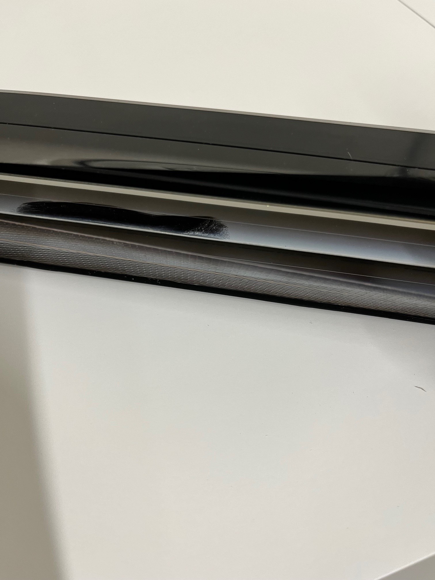

Update: we're focusing on the paper we run through the machine. Our primary application is book covers on 10 pt. C1S. For years we've been buying Tango in cartons. Recently we were offered to buy loose sheets on skids. I chose to do this because there was a lower price and we would save ourselves the trouble of opening and flattening all the cartons. All worked well for 2 skid type deliveries, then our charge wire issue started.
First pic is showing the amount of dust easily seen in the paper stack. Second pic is the resulting coating that builds up on the charge wire.
My paper rep's explanation is that it's the same paper (skids vs. cartons), but they get converted in two separate locations. The skid lot may have come off a cutter with a dull blade.

Another update - the cause of the problem was our humidifier. Apparently when using tap water, primarily calcium and to a lesser degree other minerals (as per Xerox's analysis) become airborne and wound up collecting on the Iridesse's charge wires, and a lot of other places too. Interestingly, we've seen this white haze on machine covers, file cabinets, etc... We stopped using the humidifier 7 weeks ago and there is no sign of it anywhere.

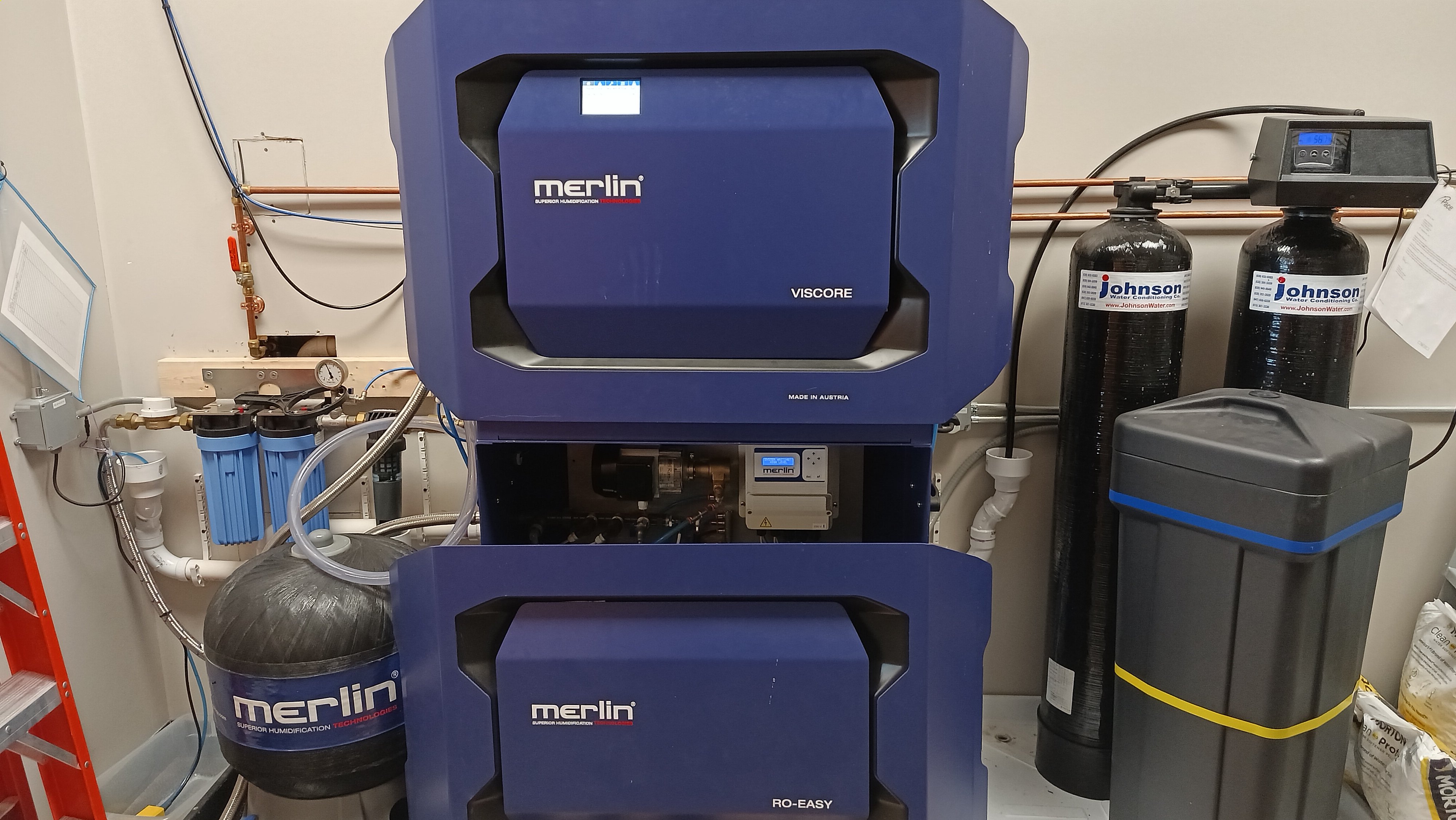

We've had the same issues, with haze deposit everywhere. RO system combined with softener system cured it. We went with a Merlin humidifier sys. Expensive but effective. Once the haze reaches your sensors.. you'll have a lot of problems. (Note: Merlin did not provide the softener sys. We did that ourselves.)
