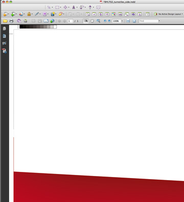

Have a very simple file that has a white box on top of a colored background tiff image. Both boxes have bleed about 0.5" outside trim. Tried the direct export from ID to PDFX1a using 0.25" bleed and compared to a file generated from the ID to PS to PDFX1a (same PDF settings) and found out that the PDFX1a generated from ID has dark lines from whats under the white zones of my file (not atomic region because they print when sent to my ApogeeX APPE rip) and shows clearly in Acrobat. The PS to PDFX1a doesn't have that problem and is a better representation of the ID file IMO. Any opinion?

Here are the PDFs for you guys to look at.
TBYLT02_turnstiles_side.pdf is the PDF exported from InDesign CS4
TBYLT02_turnstiles_side.indd.pdf was generated using PS to Distiller
The PDF setting that was used for both is the standard PDFX1a 2001 with downsampling at 72dpi and JPEG High compression (just so I could post my files here)
You can clearly see the line outside bleed area on the PDF exported from InDesign.

Oh you didn't tell us the white shape had a drop shadow applied in indesign ;)
If you look at the two as line art you will see in the postscript there is a large white object with a clipping mask. In the file from indesign you have just one shape a "pathfinder" function has been preformed to remove excess object.
You will also always get maths happening as you down sample, and some how the downsampling will be to a grid. the line is less than 1/2 a pixel (if ppi is 72)

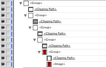

now one more thing, if you look at the two files in illustrator you will se a structural difference.
The indesign file is a bitmap has a clipping path and is then in a group.
In the post script version of this
The bitmap is
…has a clipping path and is then in a group.
…that has a clipping path and is then in a group
...that has a clipping path and is then in a group
Yes, five levels of groups and clipping paths. (for each atomic region)
Now a drop shadow on the edge of an object would only appear like this on a bleed, sinse else you would have a clipping path around white object, and background or the shadow would protrude.
You are asking why is edge of the bleed not rendered in export, well it is not the artwork, that is what the bleed is for. Postscript does not have bleed boxes by definition, and therefore these will be another level of clipping paths. where all within the artbox is rendered meticulously, including irrelevant information such as downsampled details in the bleed, at the expense of making irrationally complex structure. (I remember the times we had to ungroup groups to get them through the rips).
It is to me an explanation of how those coding must draw the line some where to get rational code and it is up to us to understand those boundaries in which we are to work. In this simple file it seems like a bad decision, but remember the rip needs to render things that are invisible in a file, and had there been lotts of detail outside the bleed you would find that the decision to do away with what is outside the bleed (or should we say aputate since we are talking about bleeding? ;P) is on the whole a good one.

Hi Lukas, great analysis. You're right, a drop shadow effect was used under the white box. I understand that both PDFs are made 2 different ways and I also understand that my APPE rip is supposed to print the dark lines since they are in the InDesign exported PDF. My point is that both PDFs generated by the very same settings are different when opened in Acrobat or printed. That could be one reason why publications that are used to PS generated PDFs are so reluctant to accept exported PDFs.
Colorblind,
The difference looks, to me, like the result of some rounding. The mask around the white element looks to be a slightly different size.
You're correct, printing and distilling will yield somewhat different results than exporting. Sometimes one will work in your favor, sometimes the other. On the whole I dislike PDF/X-1a - I would much rather have live transparency.
