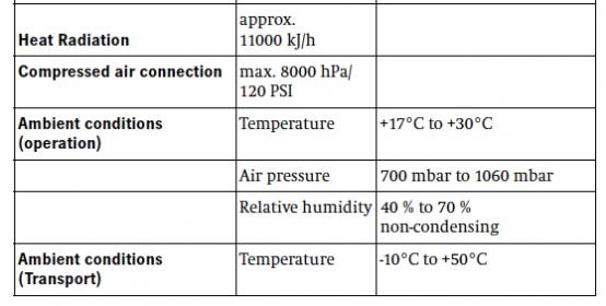

1.png.jpg 1.png.jpg It depends on the model and configuration.
For example (Heidelberg Suprasetter).

  • Make sure the room is big enough for service to have work space and remove panels once the machine is in place. This is commonly overlooked and can cause serious headaches and longer downtime.
  • Dedicated AC and humidity controls for that room is a great idea at minimum make sure existing infrastructure will handle your needs.
  • Safe lighting depending upon the type of plates you're imaging (typically not necessary for thermal plates).
  • Make sure your electrical lines have a line conditioner and surge protection.
  • Make sure your plumbing is adequate, easily serviced and that a back flow preventer is installed if you have a floor drain.
