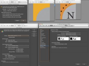

Triple checked. Illustrator's Document Color Mode is CMYK. Black previews correctly in Illustrator (as Black only). Placed in InDesign (workspace is GRACoL2006), and it previews as 4-color Black. Exported PDF is Black only.
If I turn Color Management off in InDesign it previews correctly. If I change workspace to USWebCoated SWOP v2 it still previews as 4-color Black.
InDesign Preferences/Appearance of Black/On Screen: Display All Blacks Accurately

I tried with an .ai file with tagged SWOP profile placed into a Fogra39 InDesign doc, the separations preview is correct as long as Display All Blacks Accurately is turned ON… However I am of course using a “CMYK Safe Workflow” - my colour management policies are set to ignore linked CMYK profiles (I do honour RGB profiles).
Setting a policy of Preserve Embedded CMYK Profiles, the separations preview is showing the results of a colour conversion: the blacks are being reseparated if the linked source profile and the working profile are different.

Here is a screenshot showing what I'm seeing. I would think U.S.WebCoated would convert to GRACoL2006 a little better.
