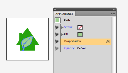

at closer inspection, using the appearance panel i find there are two effects.
The house has a merge effect applied to it. (it is not a simple object but a group for some reason)
The leaf a drop shadow with 0% opacity of that strange black. :o
I suspect these are the effects that are not distiller savy.
Try flattening appearance (or removing the effects since they actually have no puropse except keep us in a job ;) )

@rande did you try removing the drop shadow?
Did you read my post?
remove the drop shadow effect, it causes transparency flatteing and that explains your white square!
Open appearance pannel.
Select an object.
You now see the "recepie" applied to the artwork.
click the fx to edit the settings for the drop shadow
drag the fx to the trash in the appearance pannel to remove it.
there is also an option to "set to basic appearance" wich means remove all effects from the appearance pannel.

All I'm seeing is opacity and default. I tried clearing appearance, nothing and dragging and its not going away.

Okay, I saw the fx this time and that works good.
