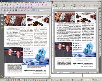

Thanks for replying. I probably haven't explained things well. The advert at the base of the page is an EPS file created out of indesign thru our Cybergraphic system and placed into a graphic frame in ID page. Then the page is exported as PDF with our printer's job options. Attached is the screen shot requested. I don't know where the white box at the bottom right of the ad in the previous PDF came from, but I've attached a higher res pdf to view

Seems like a bugg in the Cybergraphic. I'd make sire the Cybergraphic is compliant with the Magazine ads preflight found in Acrobat.

What I'm seeing in Acrobat shows that the image of the two guys is within a clipping frame. The image of the dollar-sign has no frame. Were the images overlaid by the eps?

The eps was created by an export from Indesign to the advert folder with level 2 and binary options. After a few tests, I transposed the pics and the picture on the right hand side of the ad is the one that jumps out of the graphic box.
I exported the advert as a PDF with the pictures moved either size of the ad and imported the advert into the page, then exported and the pics are fine.
