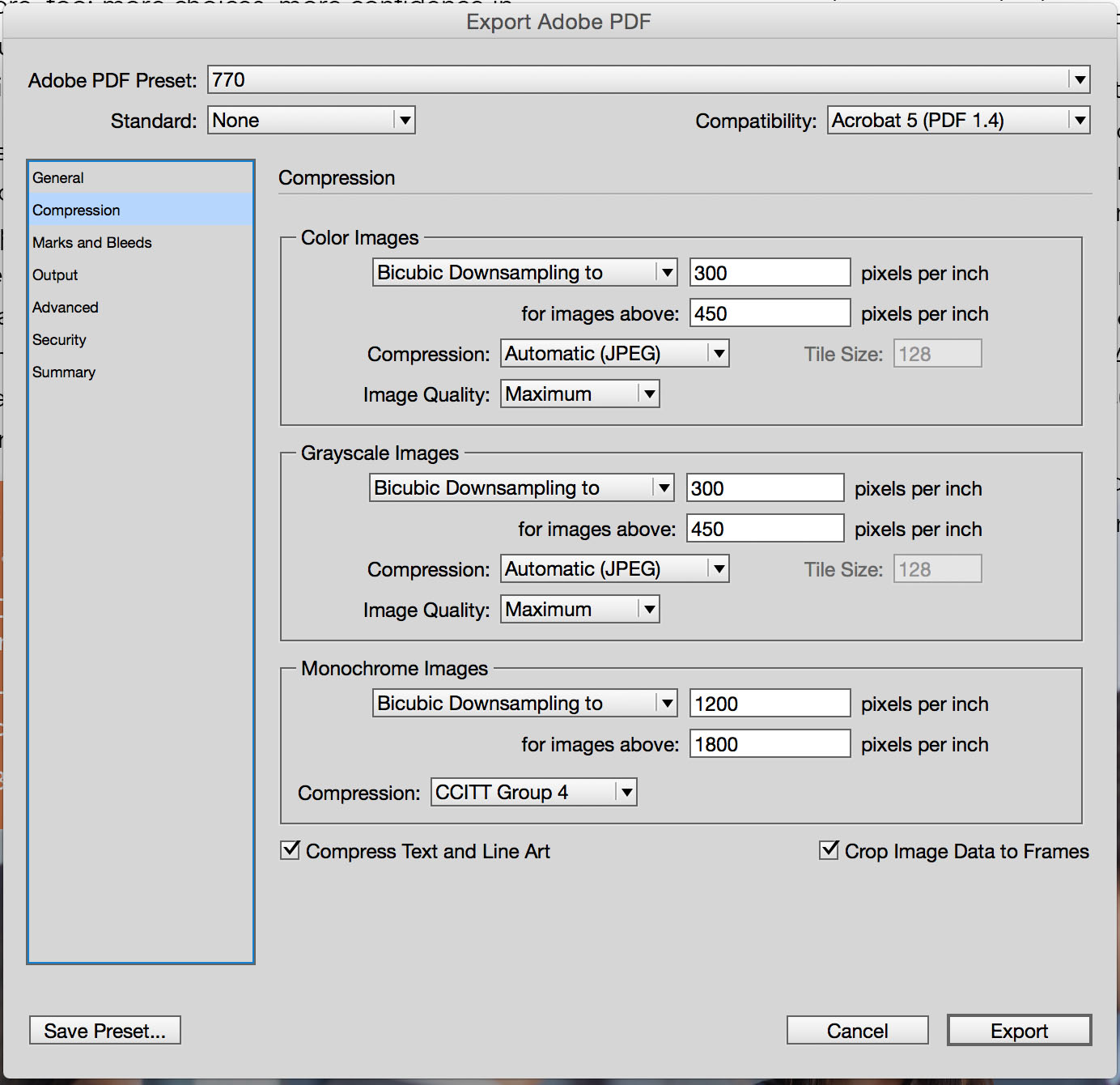

No Title
Why . .. you have a separate setting to down sample color images, grayscale images, and a third for monochrome images see attached for the setting I use every day. I have a customer that prints photos of pro athletes for their advertising collateral so I get 300 dpi images that are 6 foot tall . . then they resize them in InDesign to as low as 2 or 3 inches making their effective resolution somewhere north of 6000 dpi . . . doesn't choke the rip but it does make it work harder if you don't know them down.
