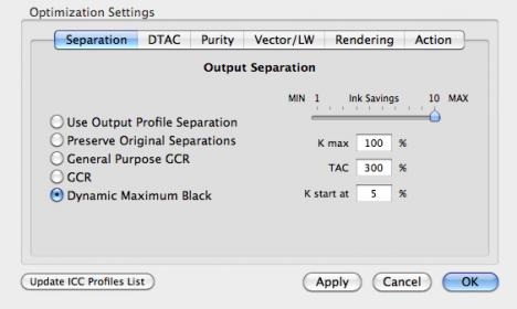

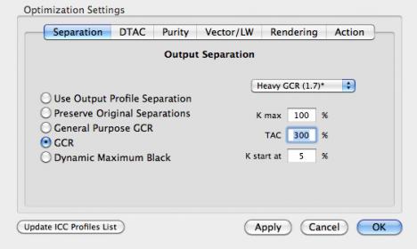

In that case I would go with the Alwan solution. I have it and it works well, although HUGE $ for what it actually does.
jay12345
Hey Tom,
Awesome thanks. If you dont mind my asking. What version of the software do you have and what profile/gcr level are you using?
Thanks, Jayson
Tommyjt
