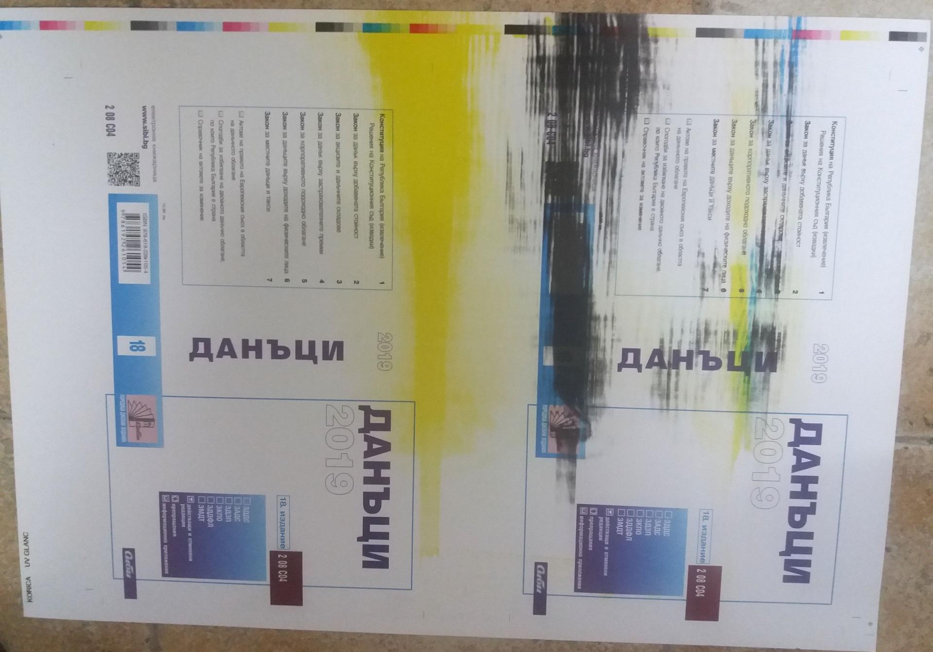

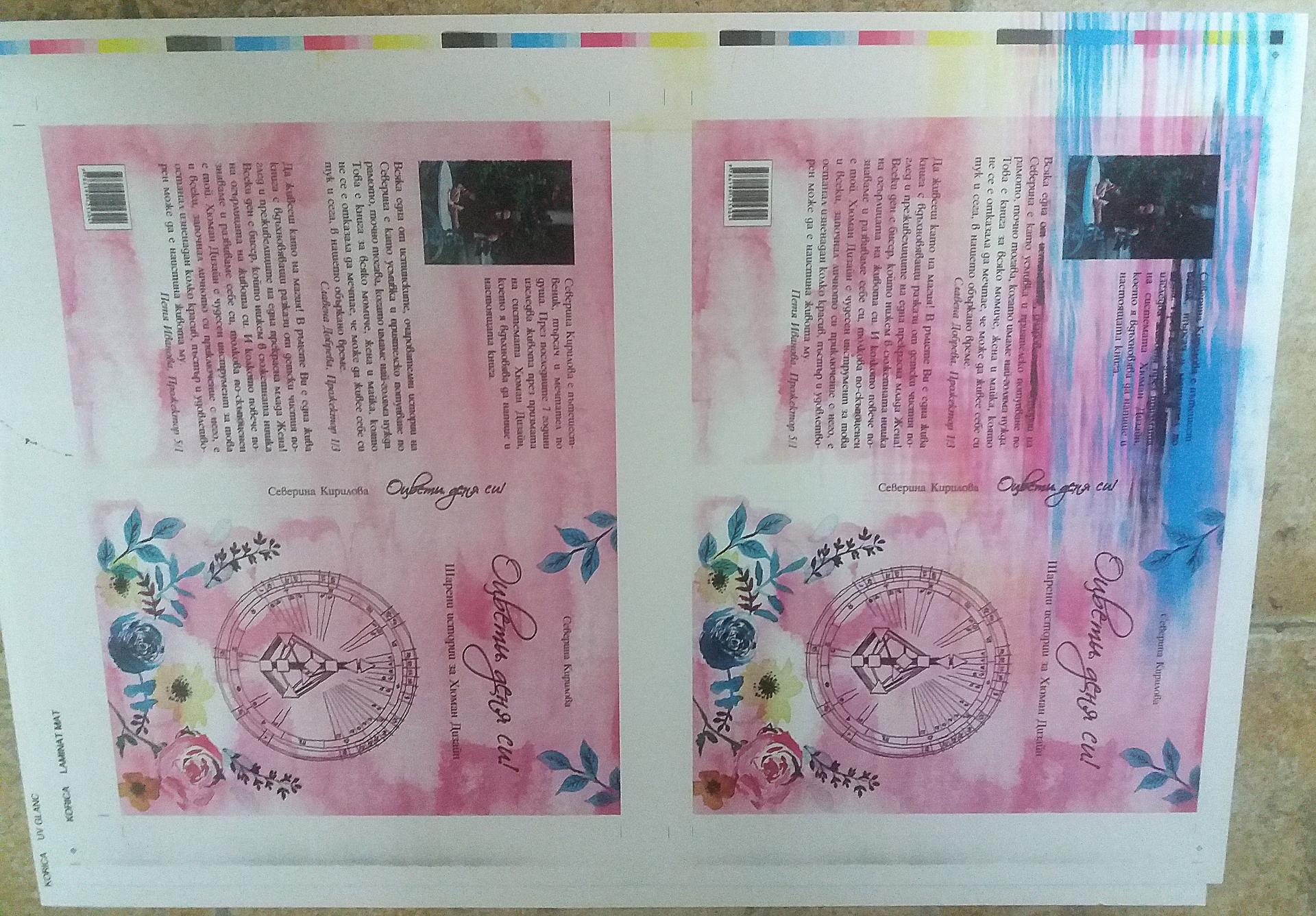

we are ctp bureau. Time to time some our clients send us prints on attached photos. It's happen immediately after printing start. After cleaning with plate cleaner, problem solved.
We are producing plates for many printers. Some clients are happy when somebody reports such problem. Everything in both processors is checked so many times.

We are working with over 20 small to medium printing plants. Most of the time all customers are happy with our plates. Only few days in 3-6 months some customer start to report about this problem. We are using Agfa gum and not changing type of plates (mostly very good but chinese or taiwan plates) for years per customer. We have no any other problems with customers - only time to time small or huge areas of non inking parts of the plate are taking ink when print start. After cleaning by hand the plate on the machine with cleaning solution everything is going fine. In the same time other printers or other machines in the same printer house do not have any problems.
We have 3 ctp-s and 2 processors. There is no signs that problematic plates are produced from some processor or ctp.
My question can be refined: Is there a role of alcohol or other additives in fountain solution in process of inking non printing areas of the plate?
