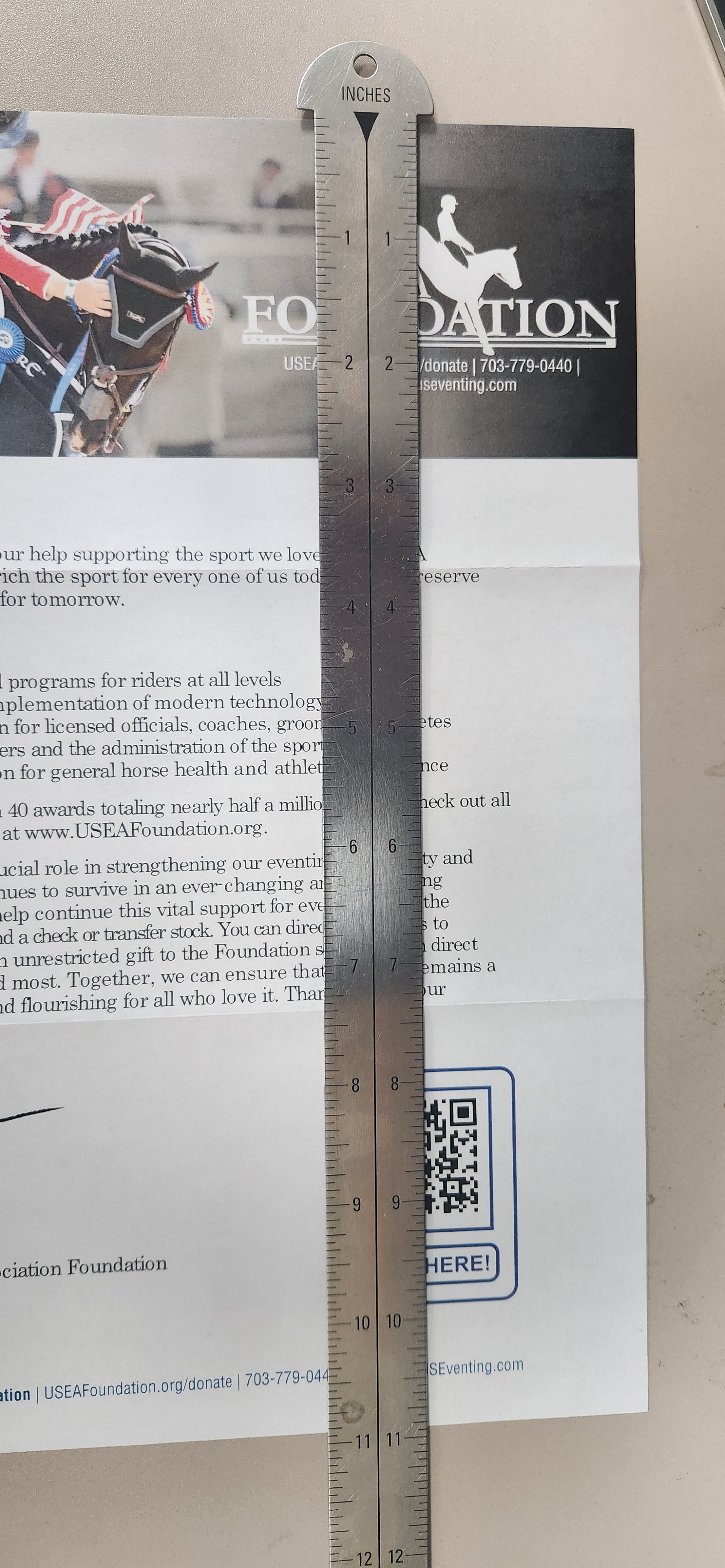

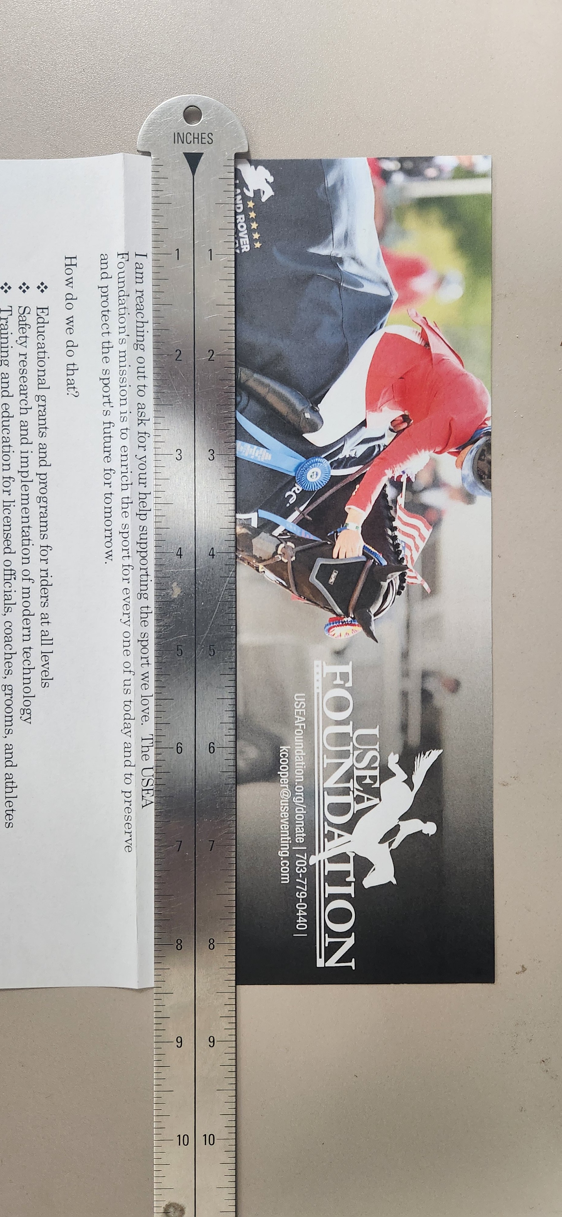

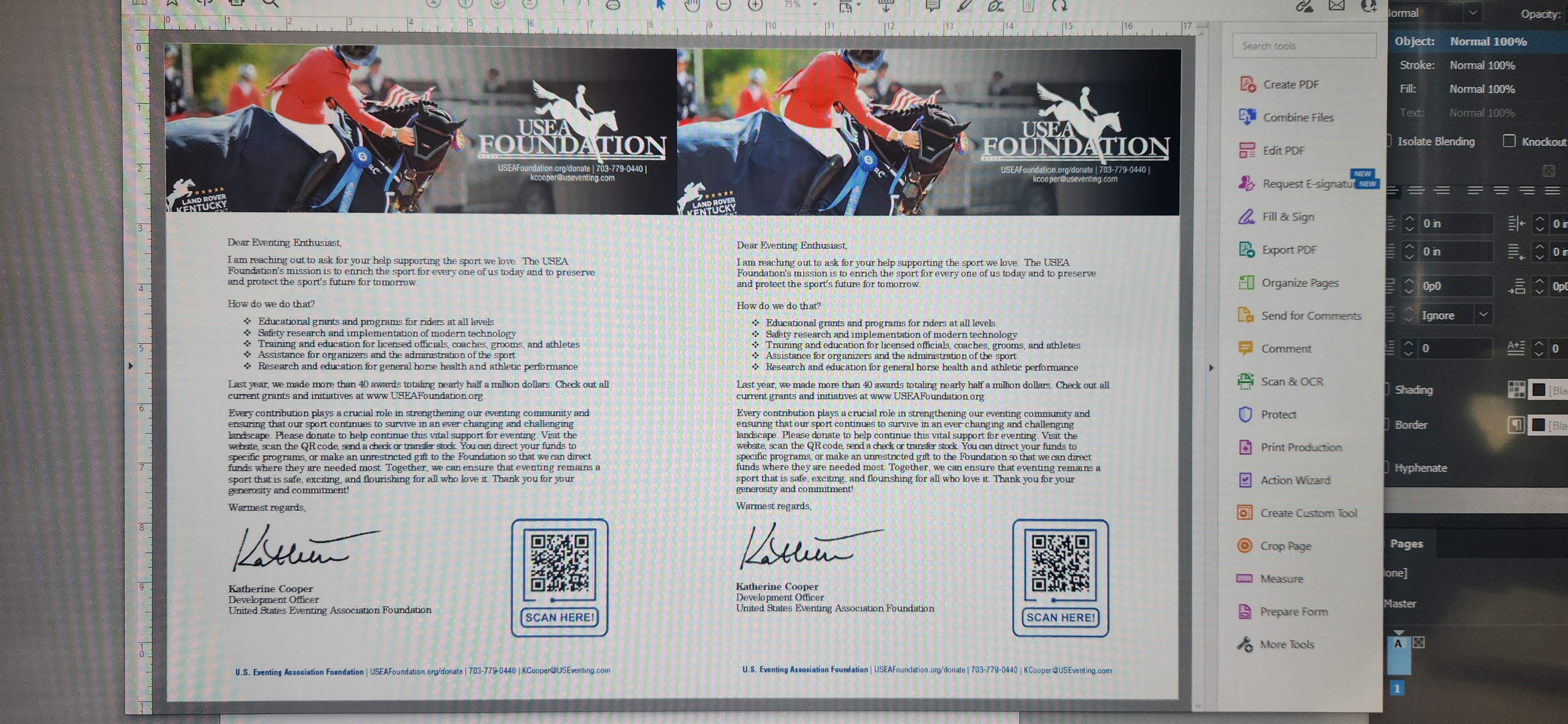

I normally run merged letters with bleed letterheads on nice stock and don't even need to shave if the bleed is in the right spot. Merged certificates with borders also. I just ran a full bleed flyer 2-up on 11x17 because when the art arrived it was a bleed and all we had was 11x17 for this rush job. It printed to the edge of the 17 inch sides and had a hair of white on the ends. We trimmed a tiny gutter out of the middle and shaved the ends. Looked great and nobody notice the slight size difference.
Here is another we just did 2-up on 11x17.
