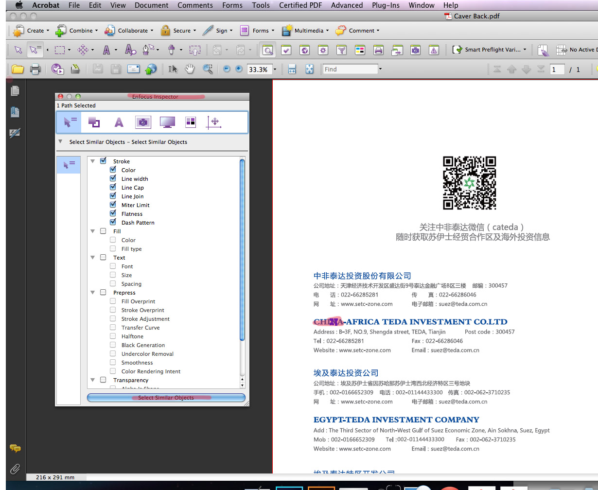

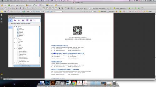

IS there way to select similar in all pages using enfocus ?
2mira
IS there any way to select similar in pages all at once instead of one page every time
using enfocus?

i take screen shot for clear what i mean

I think they mean they select something with Pitstop and then do "Select Similiar" but it only selects objects on the current page but they want it to select similar on all pages in the document.
It is pretty easy to figure out what they want. They select an object with the inspector tool and then using the "Select Similar Tool" they select objects that are similar to what they have already selected. It only works on the current page though and they would like it to work across all pages of the PDF. Select Similar doesn't seem to be an option though when creating an action list.

It is next to useless to try to work from a screenshot, the actual attributes of the object in the PDF need to be accessible in order to build an action list that can be applied to all pages.

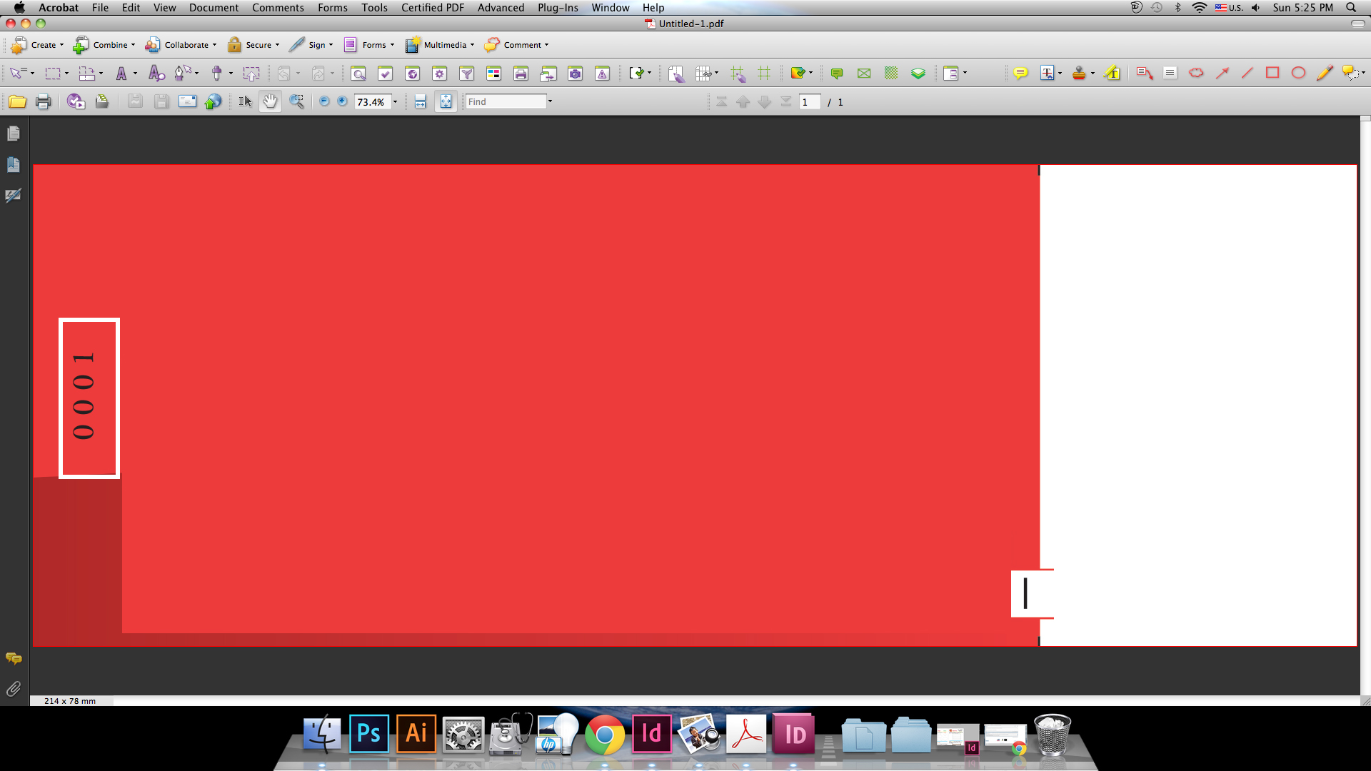

I need to coding 1000 tickets using acrobat plugin
and I need to know if i can apply font color and rotate for codes in all tickets or i cant do this using acrobat ?
Yes, it is possible to automatically select text and rotate it + change it’s colour using a custom built action list, either by specific font attributes (font name, font size, font colour etc) or by a fixed location on the page (the text is always within a specific area) – or one could chain the two approaches together to select everything in a certain area on the page but only to select by the specific font/text attributes (if the font properties are not unique/specific to the numbering and also are found elsewhere on the page).
