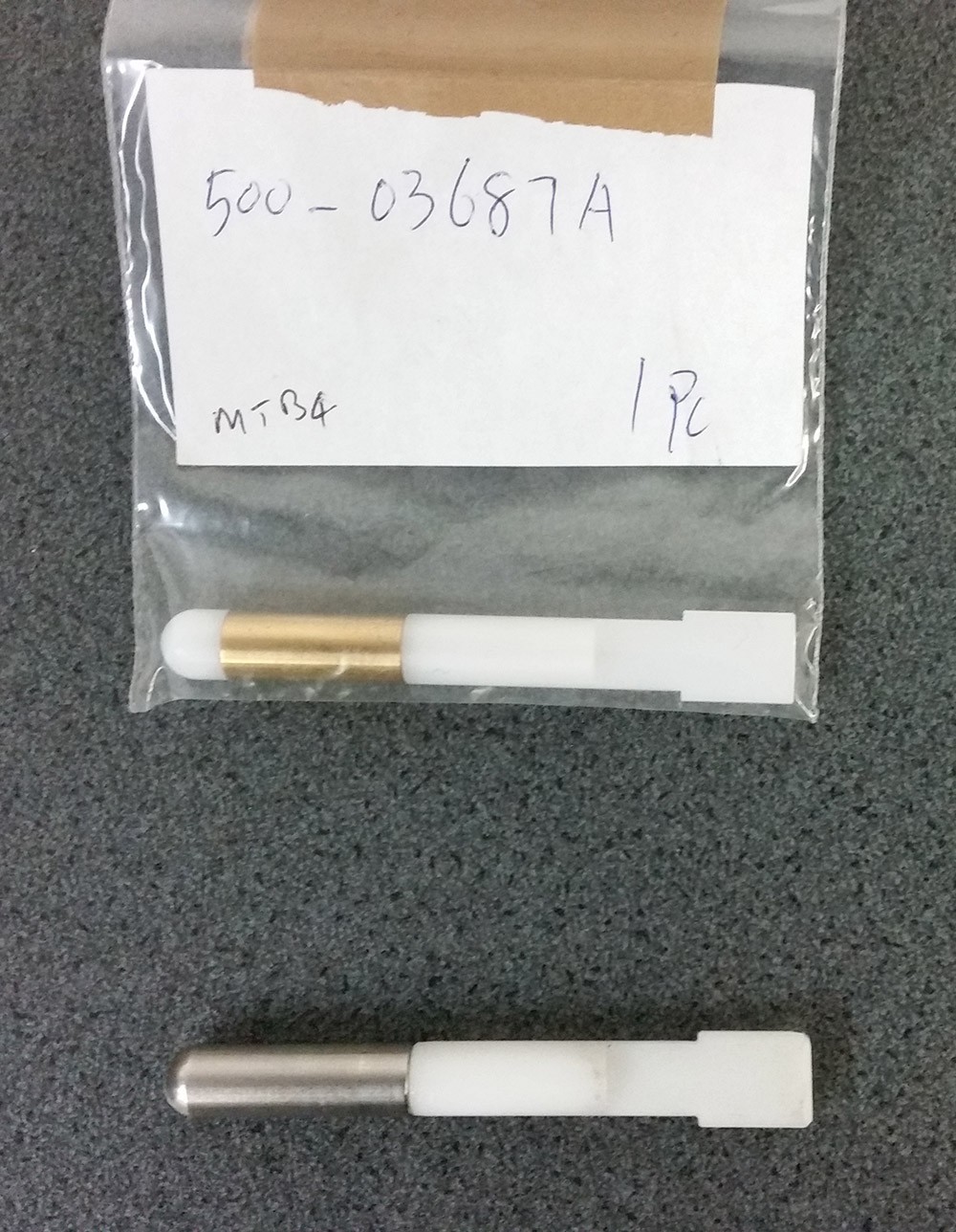

Have you got the new bar flag on the Magnus, this is required for Sonora plates as the old style scratched the back of the plates causing an issue similar to what you describe.
I will ask the question! It is less than 6 months old and installed for sonora's. But I've seen worse screw ups

This is the FCO for the bar flag on the Magnus 400. The original had the metal tip.

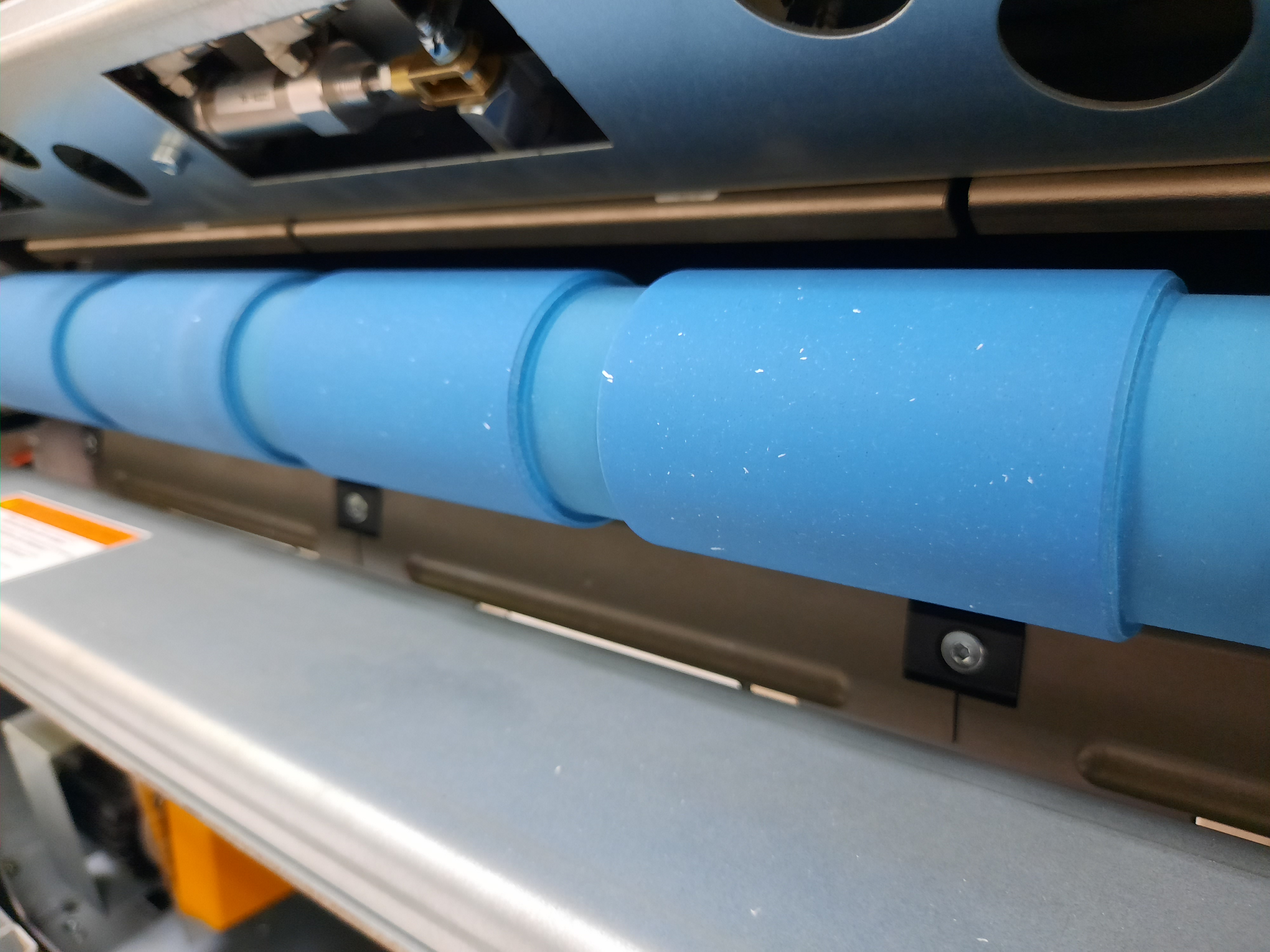

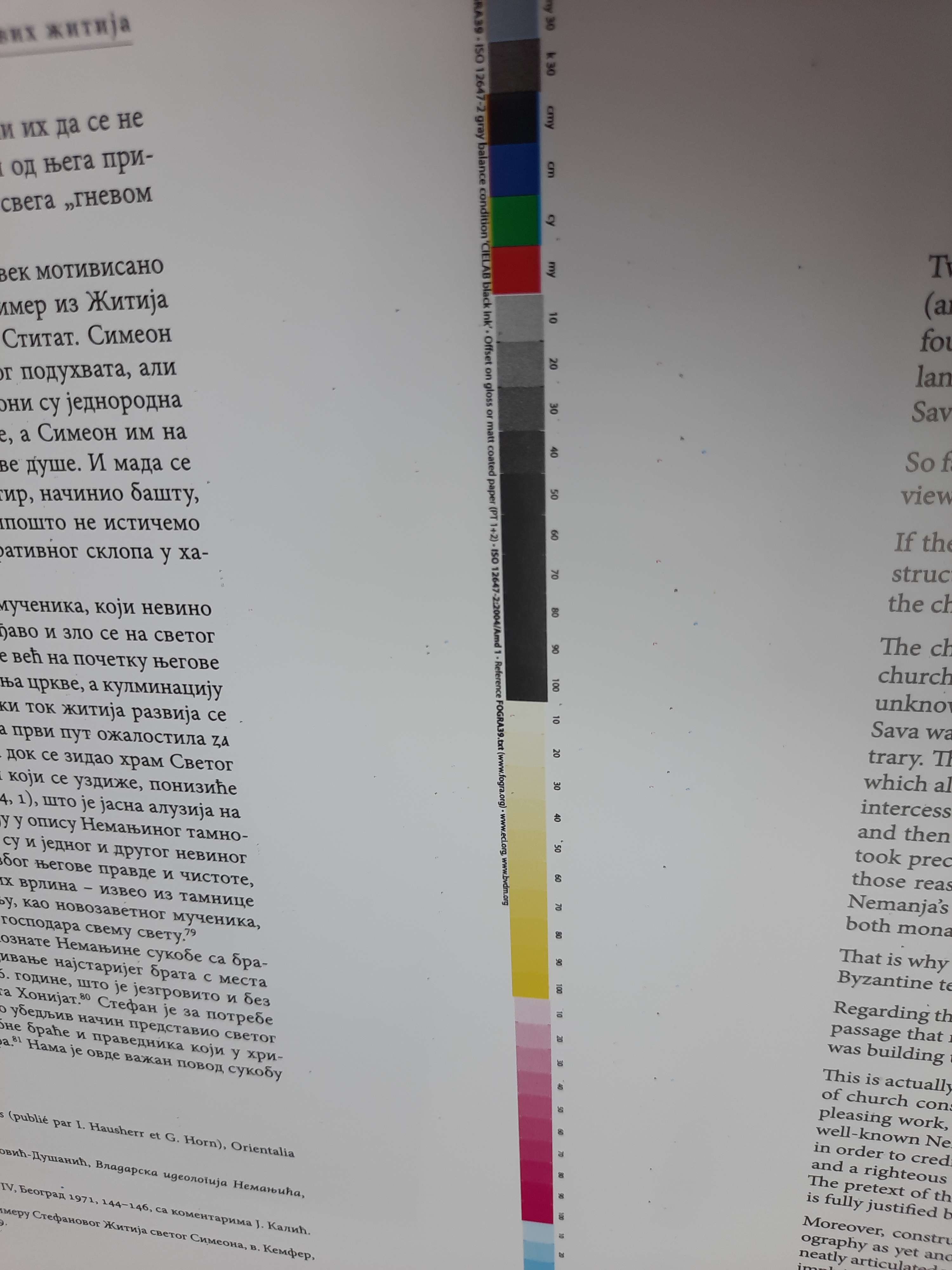

I am facing specific problems at our customer on two Trendsetters.
I am very interested if someone had similar issues, as a pressroom supporter I haven't been facing this kind of issues earlier, non my pre press colleagues are.
The thing is, imaged Sonora XP plates are showing little patterns in dots shape all over the plate - mostly in empty spaces (non printing elements) which are spreading vertically following plate side which is going around the CTP drum. This paterns are visible on the image in attachment and are NOT possitioned always in the same place, so its tricky.
The situation is the same when using autoloader and when I made "hand feeding" the CTPs manually with the plates. The funny thing is that this problem appears on both CTPs.
What I've checked so far is:
1. "Blue rollers" which helps in plate positioning when loading/unloading the plates on the drum - we suspected that some of the dirt ends on the roller surface and make "embossed" dots into the plates, but the thing is that dots on the plate surfaces are not acting like little holes made by physical damage and can be cleared by the rug and isopropyl alcohol when rub with medium to hard pressure by pressman. So they are acting like ink printable elements. They are covered by the paper dust from time to time, but when cleaned there is no difference in making "dots" on plate surfaces.
2. Checked the job files, no information for printing elements were found on non printing spaces that can made this errors.
3. After imaging part where plates are guided by table strips to stacker are not "hitting" any objects that can make scratches or dots like this.
4. Dots are not showing always, they are mostly shown after twenty to fifty imaged plates, when customer has a lot of plates to image continuously.
I would appreciate if you can give me your opinnion on this, at least in idea where to seek further for solving this.

Flag Bar, :sick: lost may hours of production because of this, and Kodak not letting me have spares. (but in the end V nice site engineers did)
stupid design just like the Finger grips for picking up the Tissue papers
