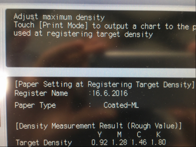

Can you please check out your target Max densities because I think technicians put in wrong ones (In the manual which we got there are different target densities) I am attaching screenshot.
