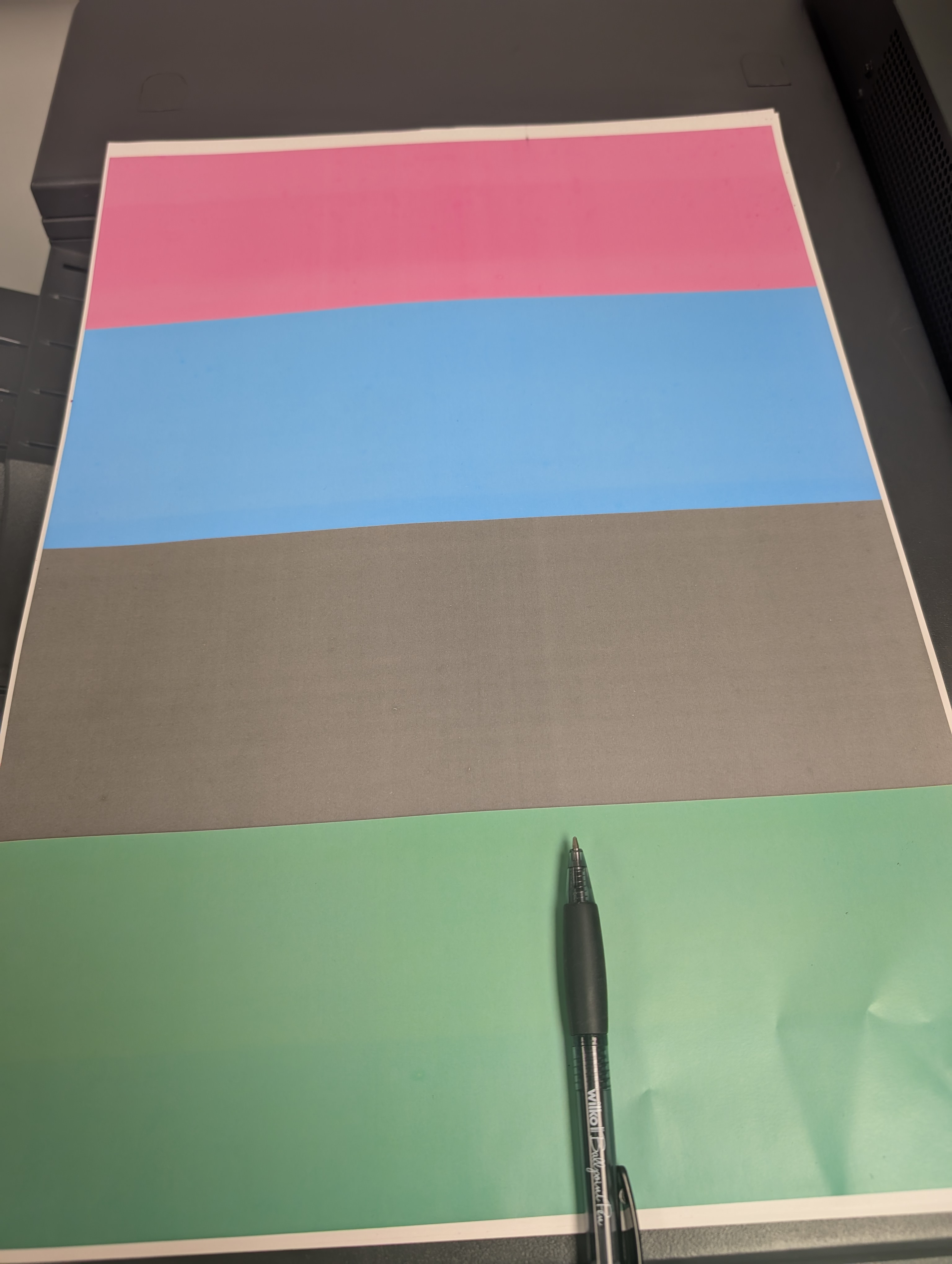

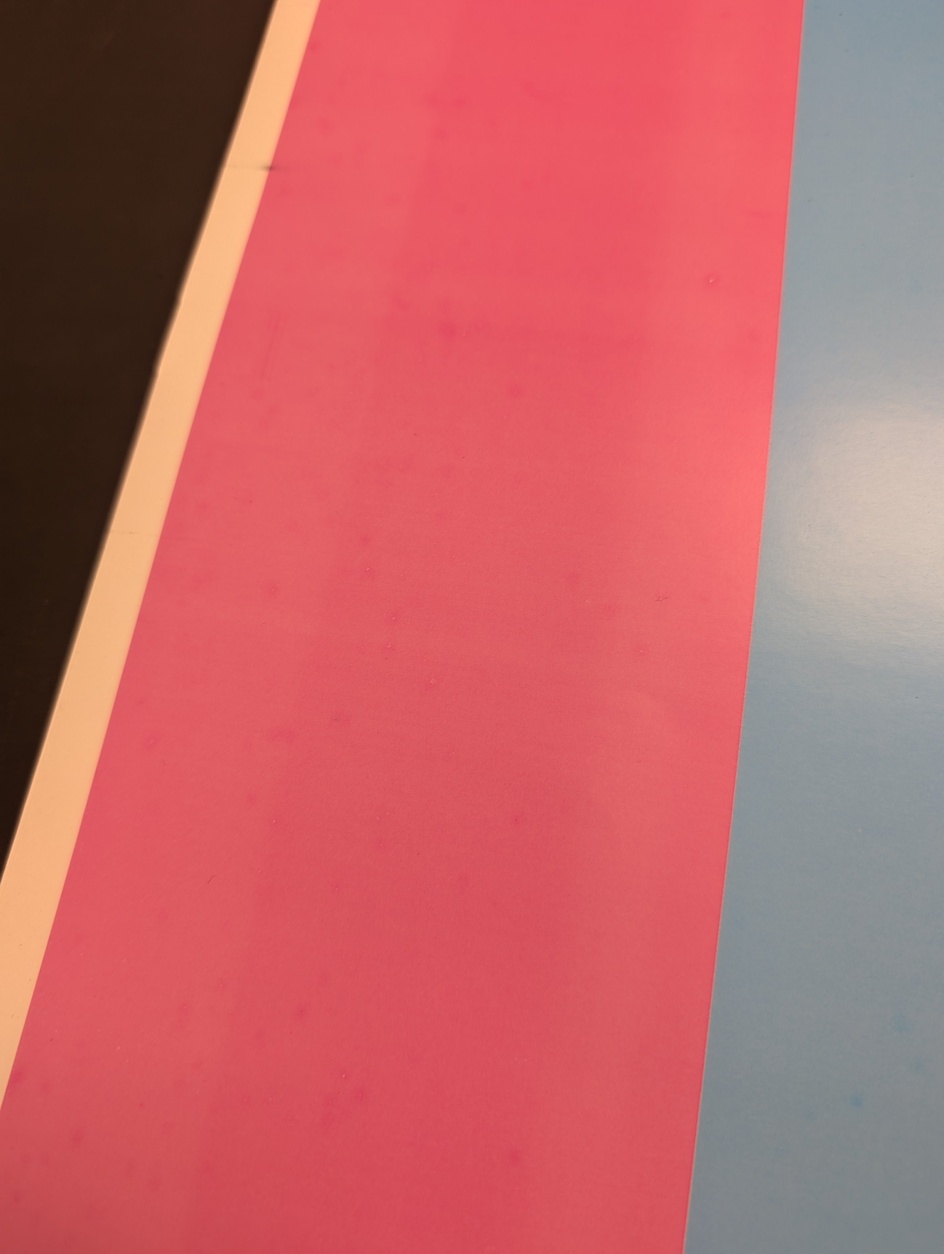

I have recently aquired a Konica 2060L I am slowly finding my way around. I have an issue with prints, can anyone tell from the attached what this could be please? I have a line going across the page (in direction of the pen), and what looks like speckles on the magenta colour. Thar bar you can see on magenta is where the transfer belt has creased a little (it was sat around for a long time), thinking maybe this could iron itself out in time? If not will get the belt replaced

The transfer belt is a mylar material (I believe). No idea if it would iron itself out. Were it me, I'd replace the belt. You would probably want to replace the transfer belt and the cleaning blade at the same time. Powder the hell out of the blade (lubricant) to avoid it kicking back a little once it is seated in place. You will know because you'll start seeing multi-color streaks in your print.
The lighter line in the feed direction might be a drum. Corona wire build up will typically result in darker lines.
