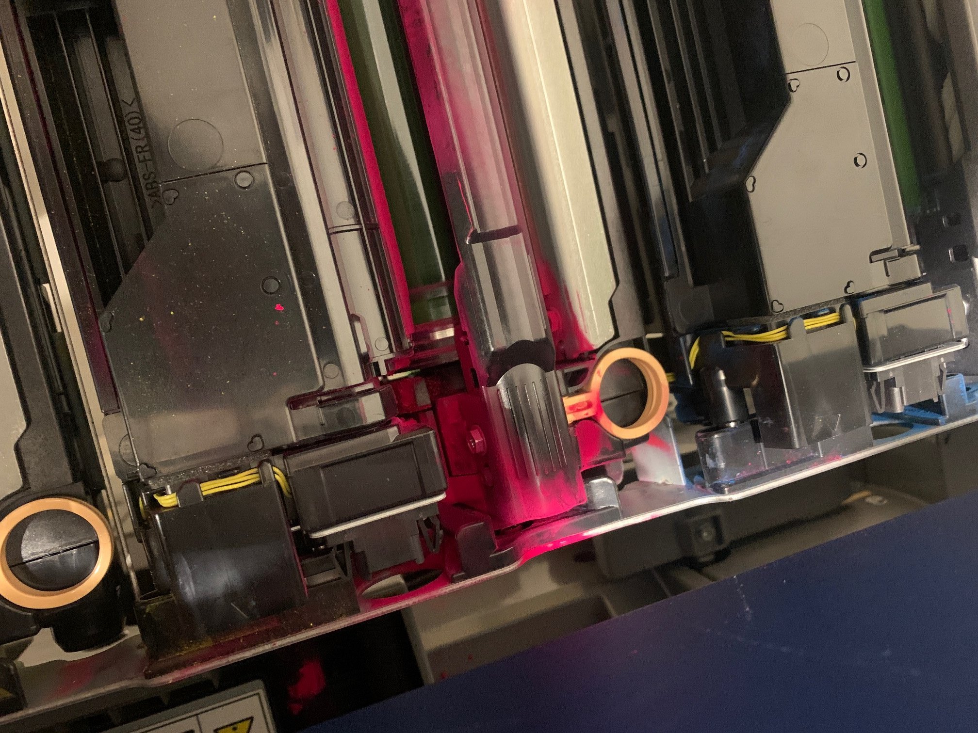

I've got a Versant 80 that I've been running off contract since the dealer pulled support following Xerox EOL'ing the machine and so far have been fine with it. A couple of weeks ago I noticed a blue tint to the one long edge of every sheet I printed. Swapped out the blue drum and it's been fine since. The same thing happened with the Yellow and a new drum sorted that.
Now, the same thing is happening with the Magenta, however, when I went to check the drum there's magenta toner dumped on top of the drum tray on the same edge as I'm seeing magenta on the prints. I hoovered this up (the best I could) and the problem went away for a week or so and then started happening again. Checked again and more magenta dumped on that edge.
I don't feel like the drum's the issue but I guess I could swap it out and see if it still happens though I don't want to waste a drum for the sake of it seeing as I am having to pay for them so I'm just wondering if any of you here know what could be the issue. Developer housings are supposed to last a long time but could that be failing or could it be bad developer?
