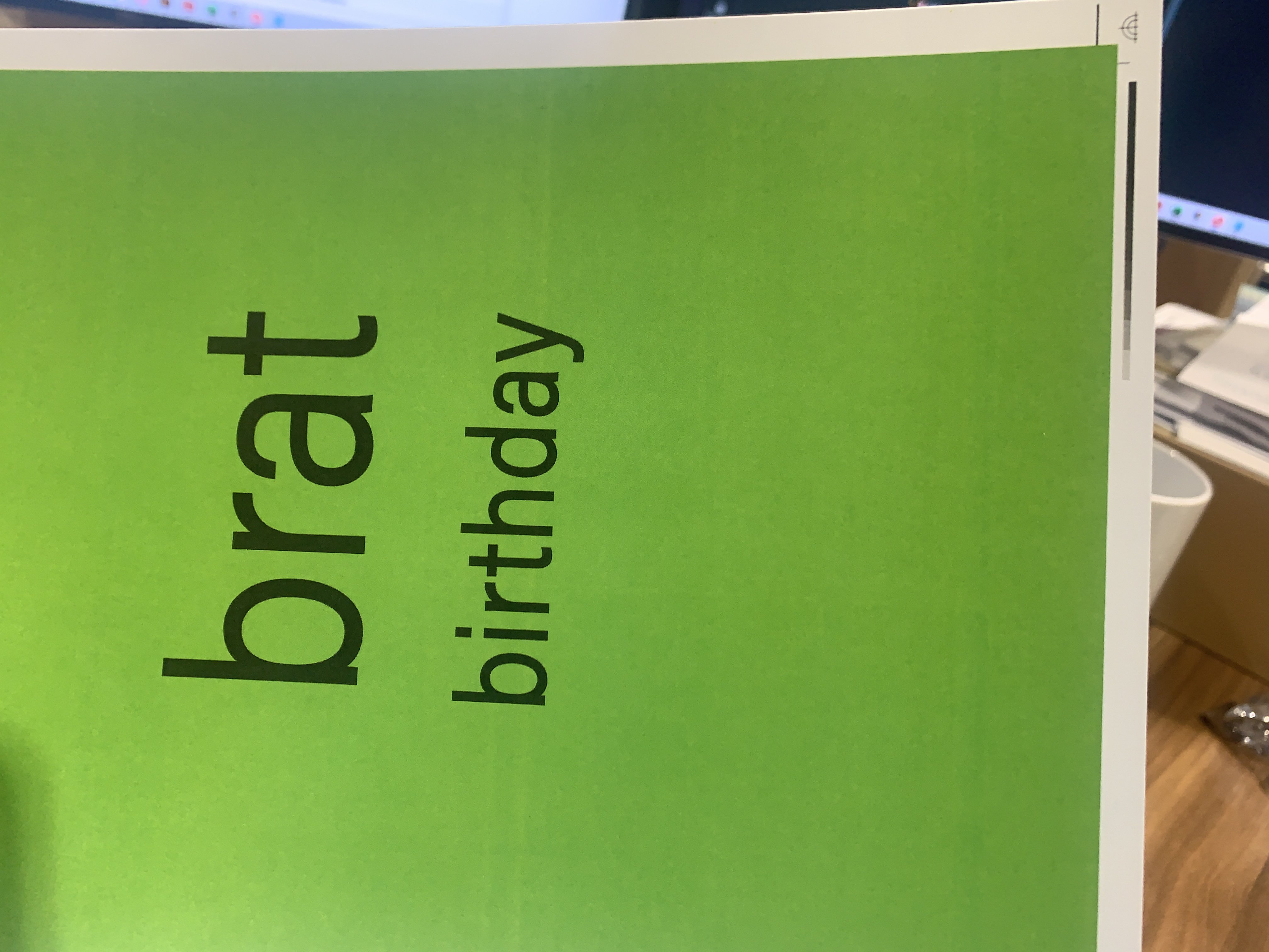

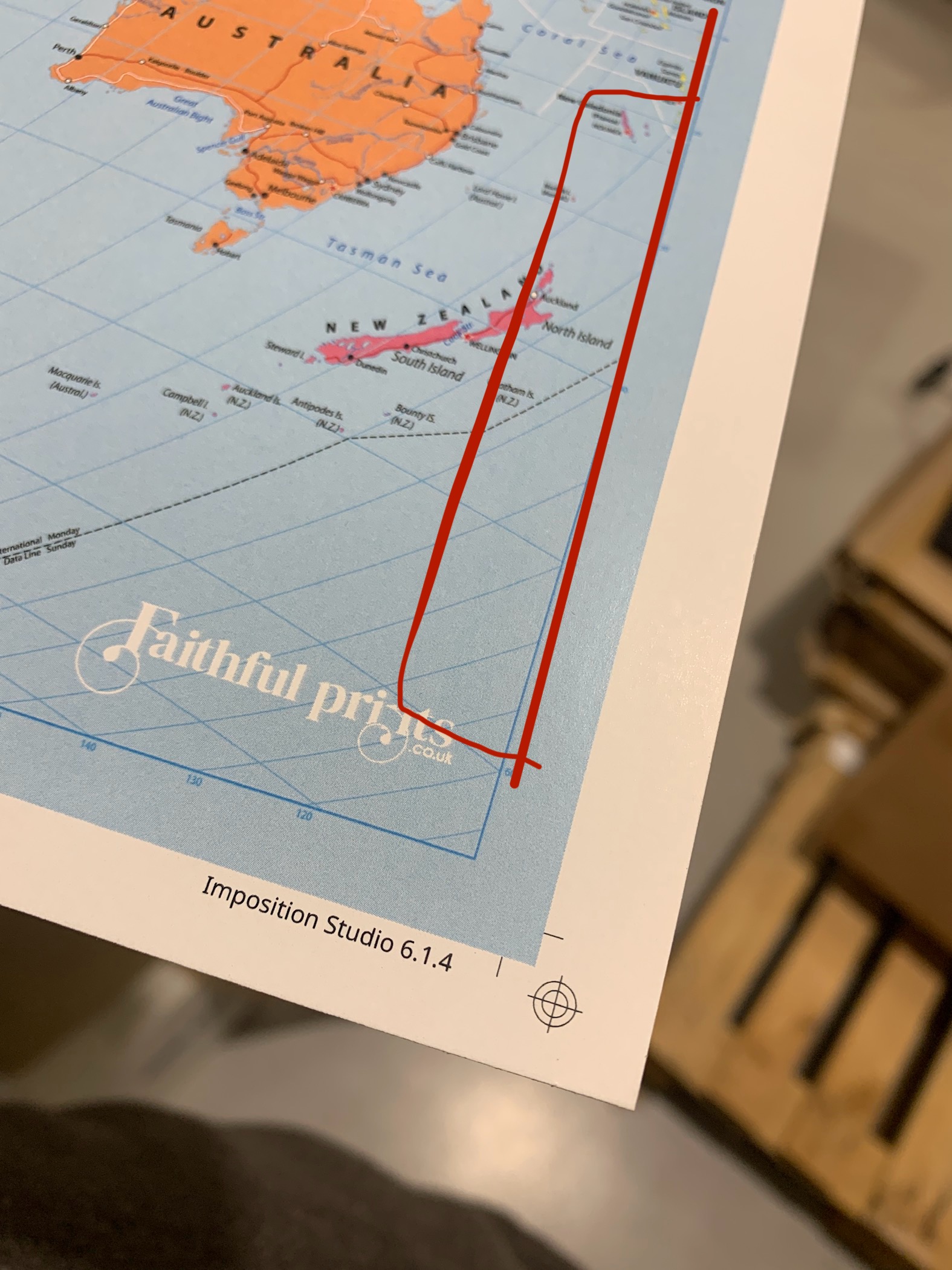

We’ve never had an issue with registration on our Versant 80 to be fair. It’s just solid colours are awful and constant banding within a day or two of the engineer fixing one lot of banding. The below photos are meant to be solid magenta and solid cyan. The green is also supposed to be a solid green.

I see what you are posting and in the last few years there has not been a request from any of my extremely diverse set of clients that has shown issues similar to what you are showing me, that has not been resolved by replacing drums/developers/transfer rollers/etc.
I think if you use the little stick with the brush on it, and clean above the drums, that should eliminate the problem on the green sheet.

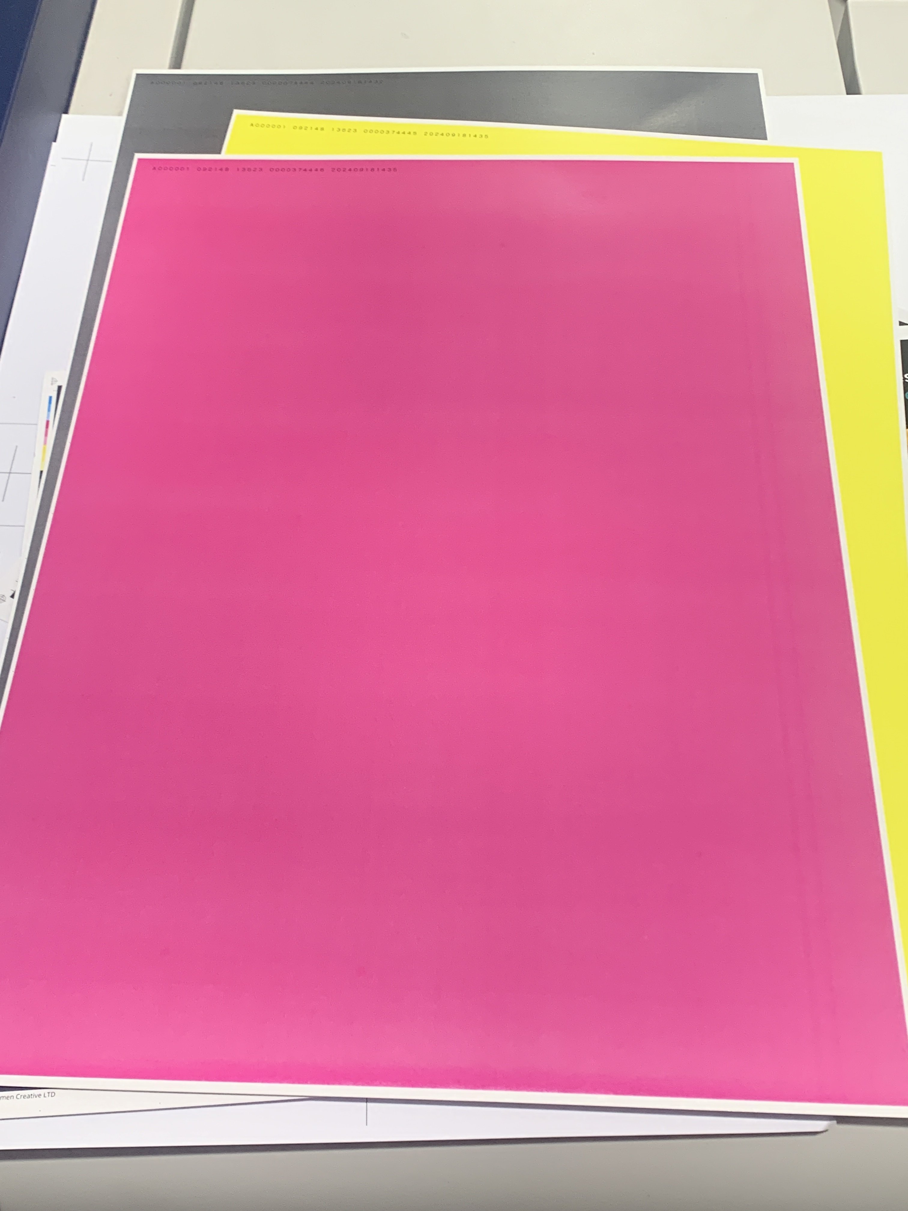

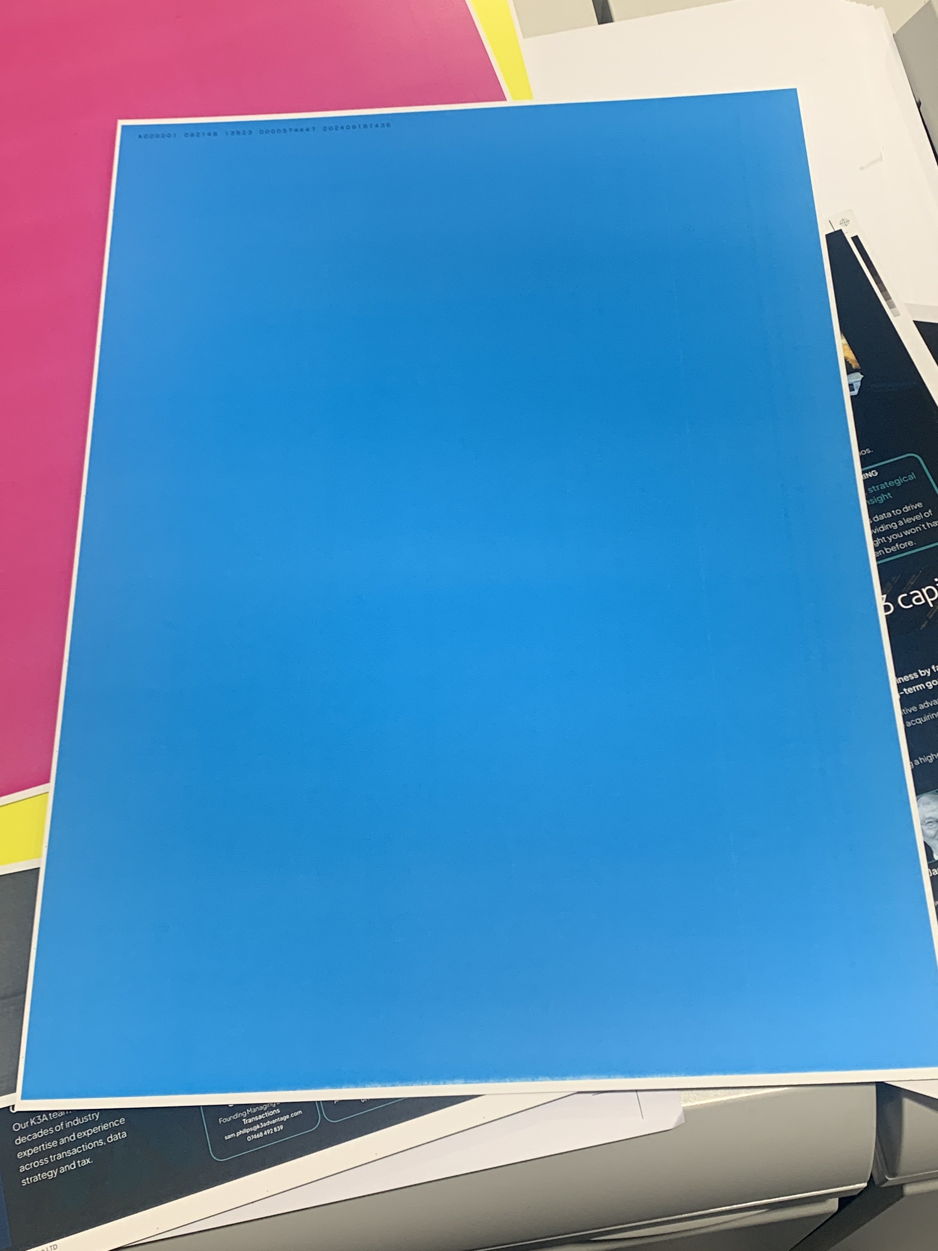

The green was actually fixed by the engineer replacing the cyan drum, and cyan developer and housing in the end but two weeks later, the cyan drum began putting a line down everything with cyan in it so had to swap that again yesterday. The engineer also ordered up a spare drum for the yellow but I had to put that in the magenta slot yesterday too.
The magenta and cyan sheets above are after the new drums went in and I’m still getting darker lines as you can just about see in the attached image (in the centre of the red box).

It sounds like you have different drums than us. Take a picture of your new drums. I'm curious if they are the same color as ours.

So, our Xerox service provider has come back saying that the darker line on the printed sheet is called 'impulse banding' and is typically caused by us printing mostly 350gsm coated stock.They've said that slowing the fuser down should solve the problem but if that doesn't work, there's nothing else they can do and that the print falls within the realms of the customer expectation document.
