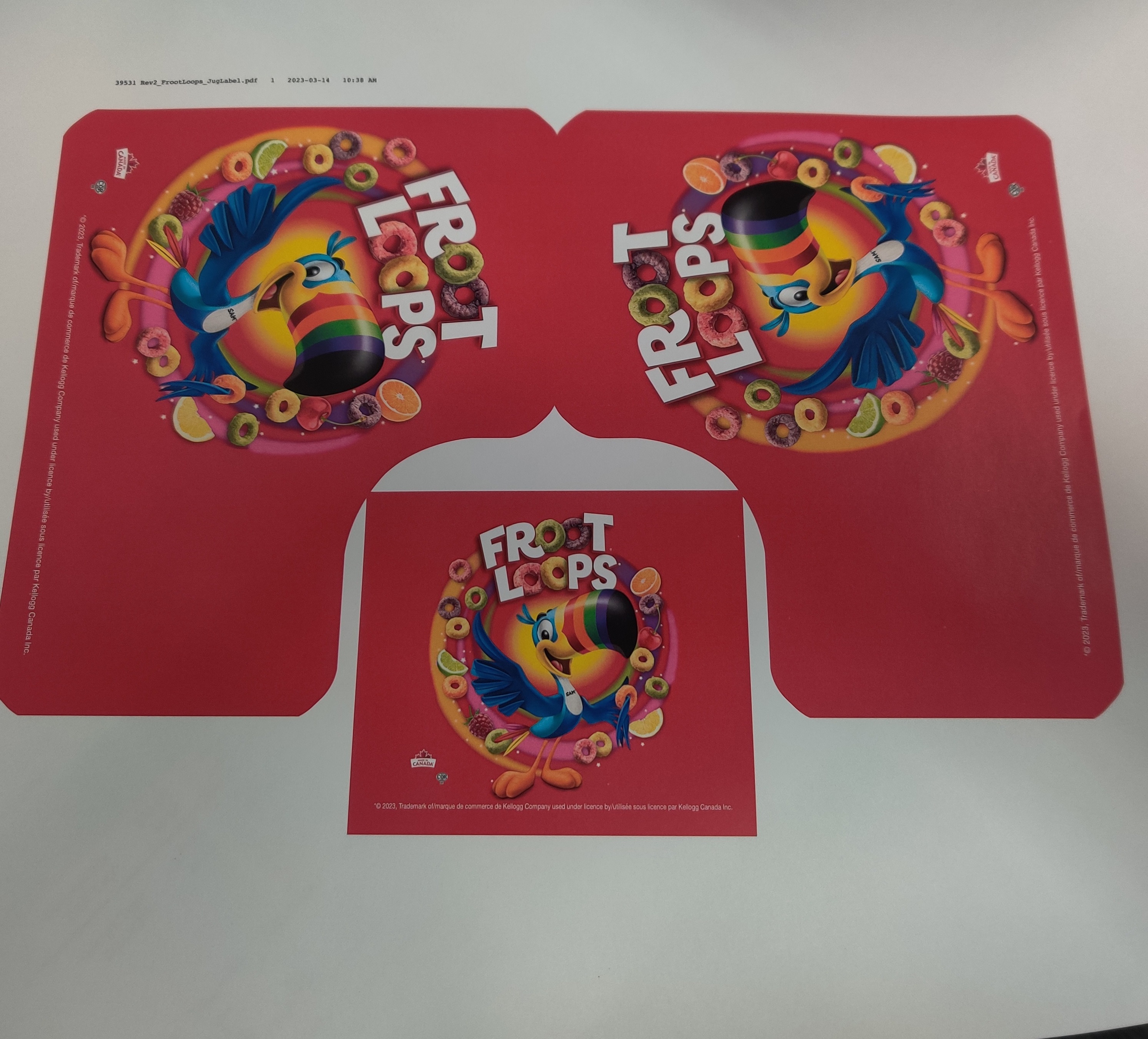

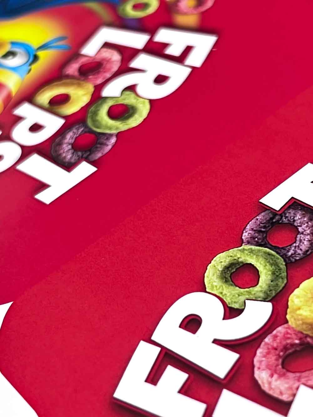

Thank you! I have run a test with the new settings... the colour is better, but I still see a difference between the two images. Photo attached - my camera is not picking up the difference very well but it is easier to see on the press sheet.

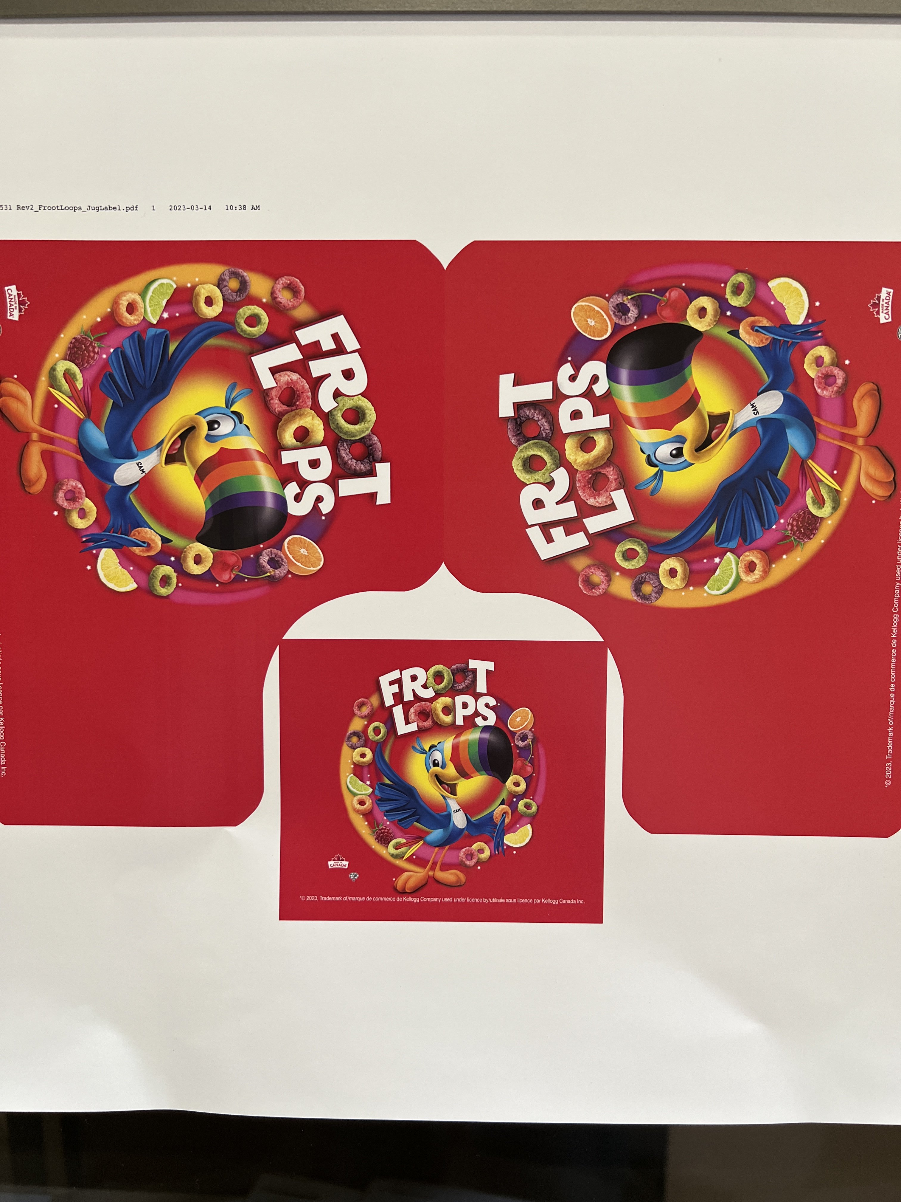

I did try the MOD file, thanks for sending along. Unfortunately same result. Here is a photo of the print.
