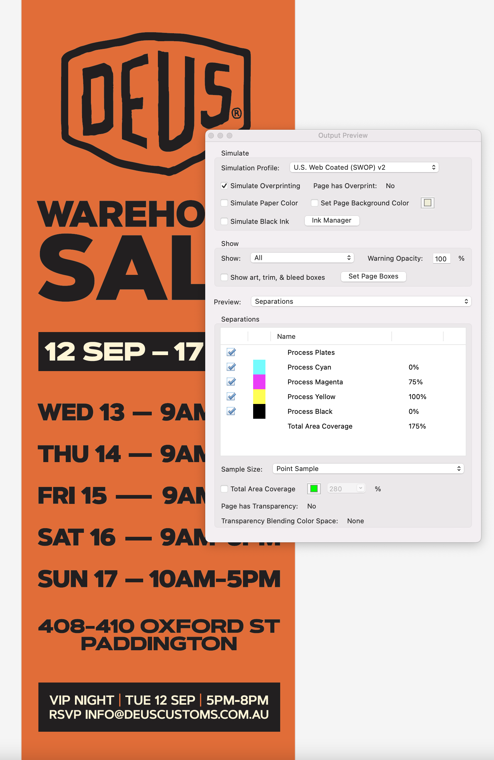

hi this orange is 75% magenta & 100% yellow, I'd print 100% & 75% of each colour & have close look. When they installed our 4070 besides several 100% prints of cmyk they also printed numerous full sheets various single colours.
