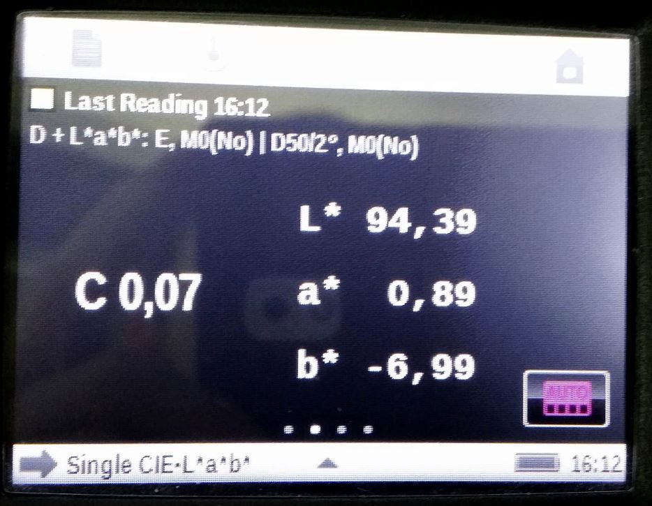

Same paper, measured with eXact adv in spot mode (M0 condition) shows L 94.39

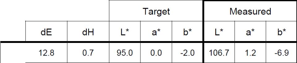

What are the full CIELab values of the two measurements? Is there a color shift too, or just lightness?
I don't believe OBA could provide 13 units of lightness - that's just too much. Lightness in CIELab is computed only from the Y component of CIEXYZ, and OBA generally tend to increase the Z component (the blue end of the spectrum).
I'd put it down to some sort of software bug maybe?
ok, from colorflow: L 106,7 | a 1.2 | b -6.9 – averaged from 3 patches colorflow.jpg

from exact: L 94.39 | a 0.89 | b -6.99 exact.JPG
