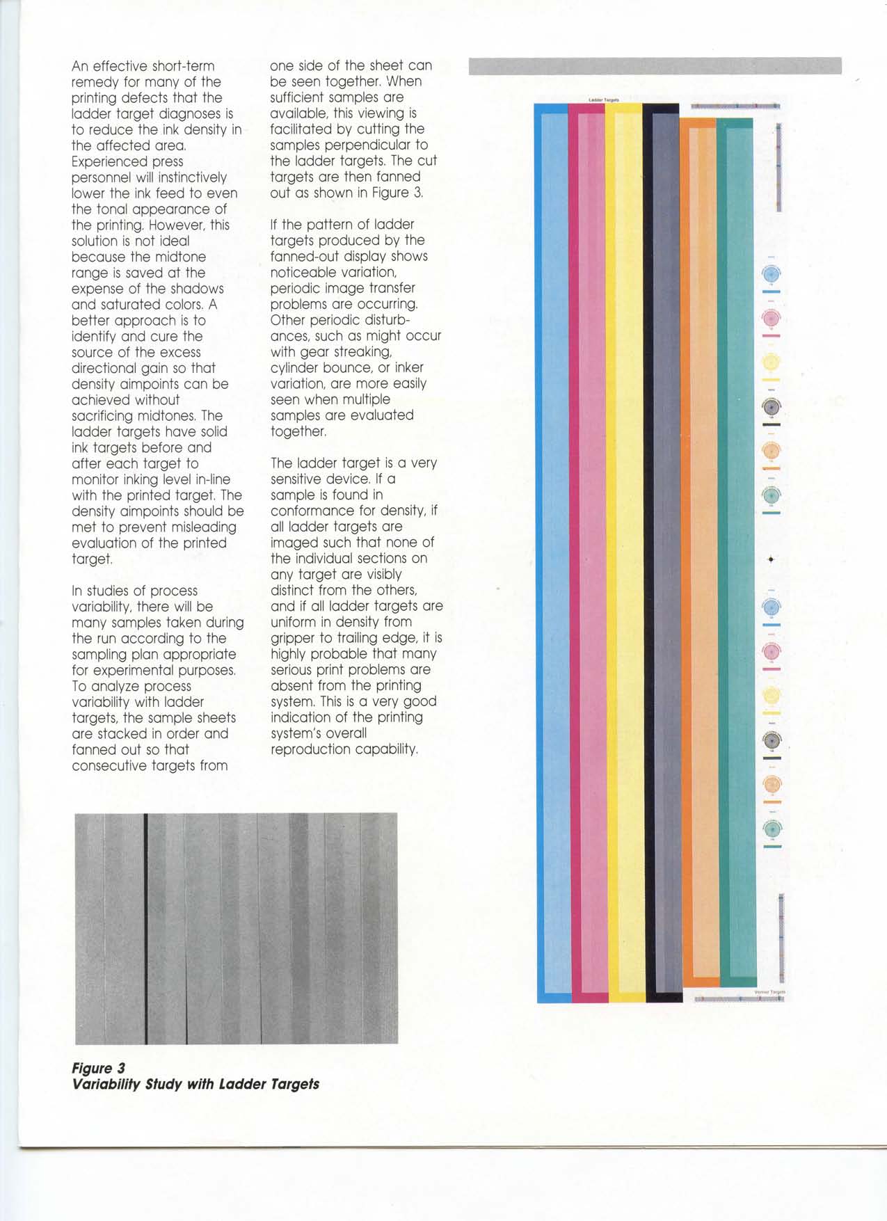

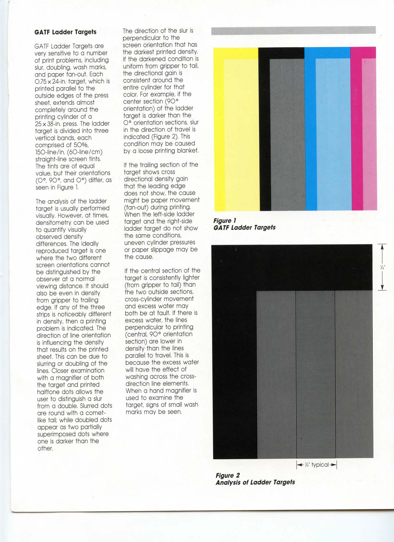

Attached is the User Guide for Ladder Bars that will truly show press problems. Call with any questions 412.889.7643 or [email protected]
