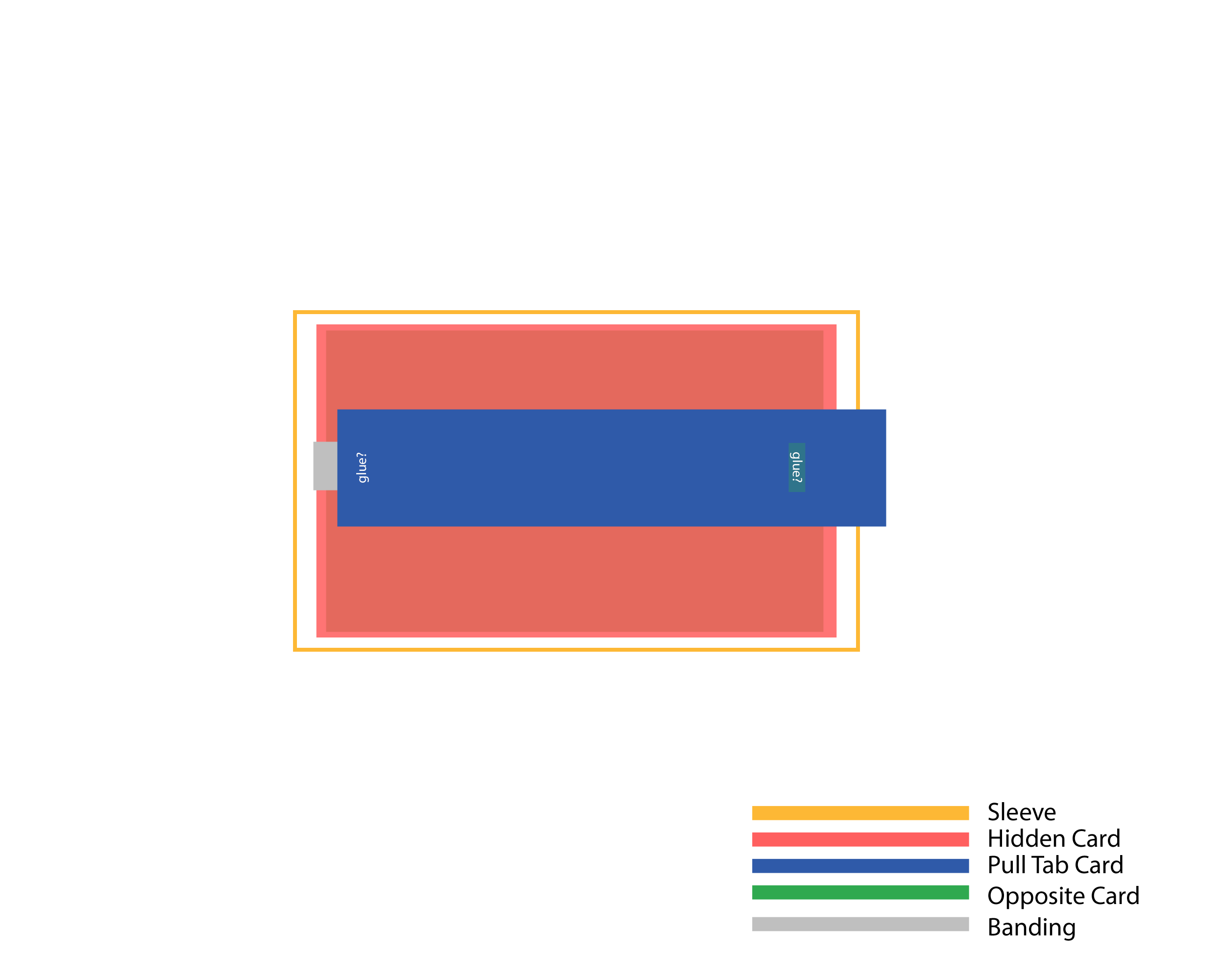

The way I envision this working is there is a sleeve, the pull tab card, the opposite side card and a center card that is not seen. There will also need to be some kind of band.
The band would fit loosely around the unseen card. The pull tab and opposite side card would be affixed to the banding on opposite sides of each other. (the unseen card would separate the two revealed cards). so that when the tab is pulled the band rotates around the middle unseen card, revealing the contents of the pull tab and opposite side card. I have drawn a basic picture to help.

Your design concept looks accurate. You will need highly flexible ribbon for the banding. I would also recommend that the hidden divider piece be a gatefold so that the ends are smooth and rounded for the ribbon to slide easily, not a cut edge. Find someone with a digital die cutter so that you can easily make adjustments as needed.. If I was doing it, I would probably opt for a finger cut out on the card rather than a tab sticking out.
Thank you. Great advice, I appreciate it.
