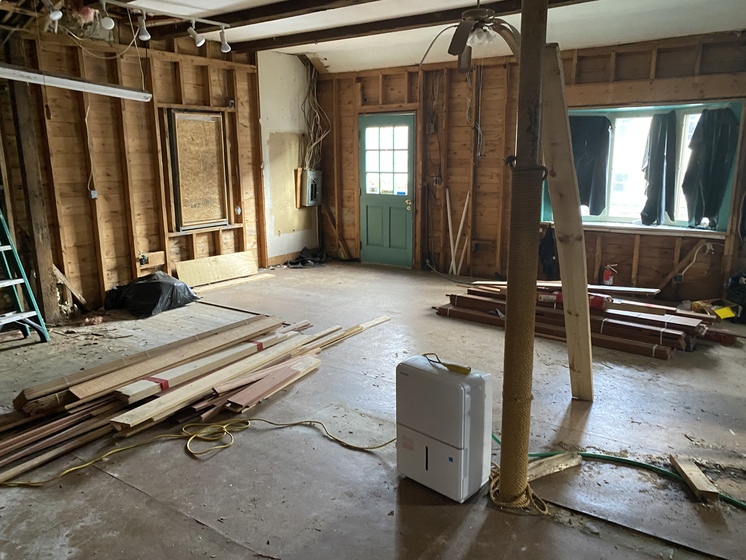

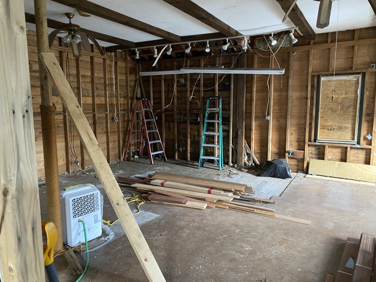

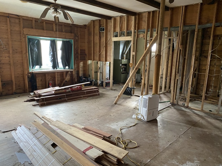

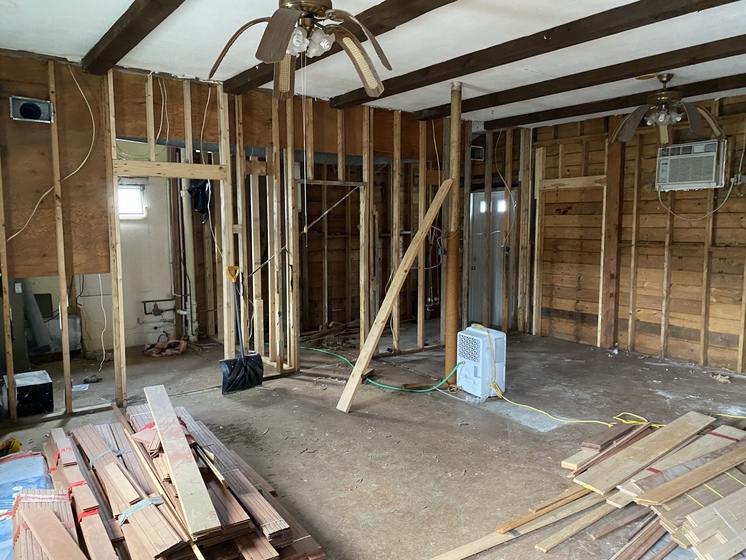

I had not been to the building in a while so I just stopped by. It is much smaller than I was picturing and seeing the size of some of the equipment I can certainly see it filling up quickly. I am thinking I can maybe make this the retail front with some basic equipment and then, if we grow, have that rest of the equipment and staff working at a warehouse style complex somewhere else.
With that in mind, I would still need some equipment here that I would probably move to the other location in the future (for example a guillotine) but I don’t have a ton of space, especially if considering I’ll now want to put in things like a reception counter. So, I can probably get 4-6 pieces of equipment in here at the most. Does that change any recommendations people have made before or is it still the same?
I’ve included some pictures here of the space. Please excuse the mess. I can move/create
any walls but I’m thinking open floor plan would make the most sense. I just need one space for a restroom and a utility room.

@new2print - looking at those photos of your building, you may need a wider external door. The engine & paper decks on a digital press won't go through a standard pedestrian width doorway.
Thinking of our inventory, the guillotine, laminator and flatbed digital die cutter would also not go through a standard pedestrian doorway.
If you're able to add a permanent ramp on the outside, leading straight up to double doors, this will greatly assist with getting both machines and pallets of paper straight into your shop.

Most people overlook the electrical needs for all this equipment. Also can your floors hold the weight?
