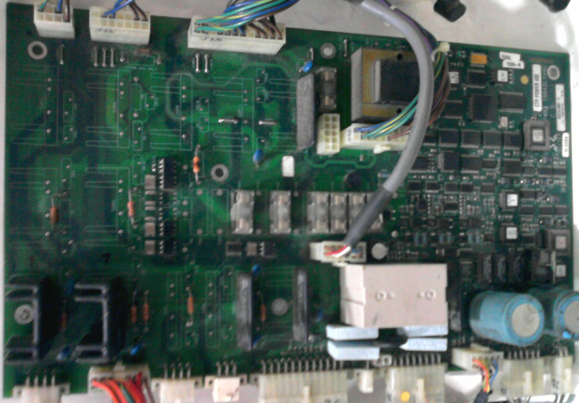

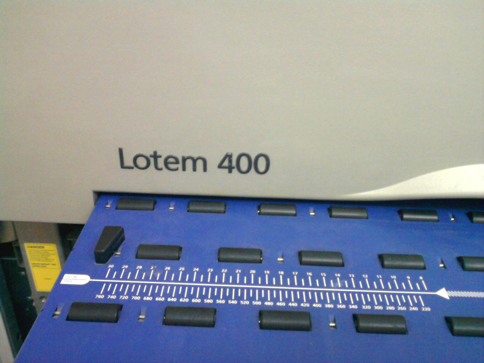

we are having Creo Lotem 400 CTP earlier it was working Smooth we having 23 Laser LD and since last three month we face one problem like startup earlier its start immidiate but now its take 2 hrs to start some time it star in 20 min some time more than six hrs so i ask somebody so they say its may because of loose contact or door switch problem so i checked all switches all are working fine ...later on i checked back side CTP Power 400 Board connection all are connected can anybody Help Me What it is Problem how i can solve this or need to replace any board ... Thanks in Advance

Sir ones machine is standby working very smoothly , everything is perfect working, i tried to connect windows pc seprate power, windows 95 booting but say ddb card error when i checked throughly i found that from power distribution board ( CTP Power 400 Board ) two output ....... one goes to DDB BOX and another goes to PC Box theres was no output current its need 230V that 230Volt missing can you guide me which relay control this voltage on and off or if possible can you give me block diagram of power distribution Boards ( CTP Power 400 )

YOur cheapest solution is to run the PC from an external power source ( 230v) and the L Box ( with the lasers and DDB board) from the {Power Distribution Box). The problem with the Distribution board could be a solid State relay is down.
