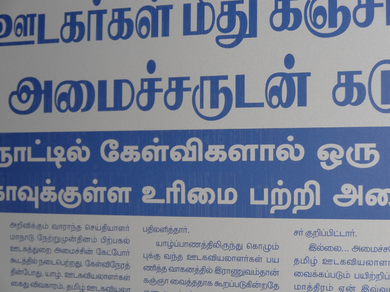

We are using a Lotem 800 V and are finding lines on the plates. I have attached a pic. There have been similar threads on here but i cant find out how they were resolved.
The faster the drum speed the more intense the lines are (900rpm)
We have changed the V pads, silicone oiled and cleaned the V groove and still the lines appear
We have identified it is the lotem and not the processor!
The lines run vertically same direction as the drum
Anybody had a similar problem and found a fix??

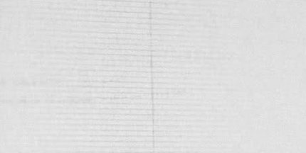

We are getting lines on the plate too, but these line are very different from the lines talked about on this forums.
Please see the attached image.
Any advise is really appreciated.
