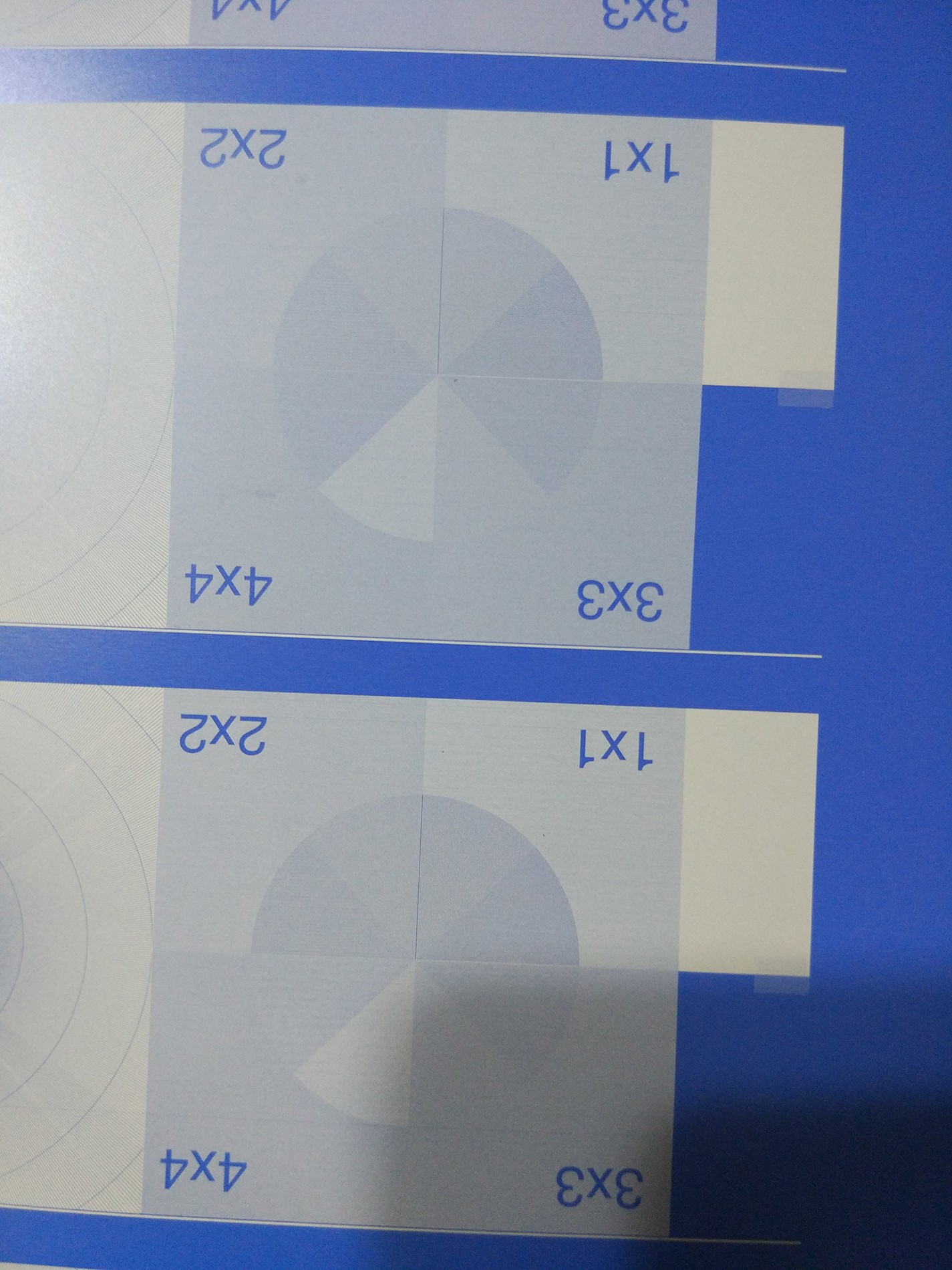

R rıza keskin Member Jan 5, 2018 #1 Hello. I can not get the lines out of the mold. What should I do? Attachments photo7243.jpg 476 KB · Views: 385 photo7244.jpg 523.6 KB · Views: 373

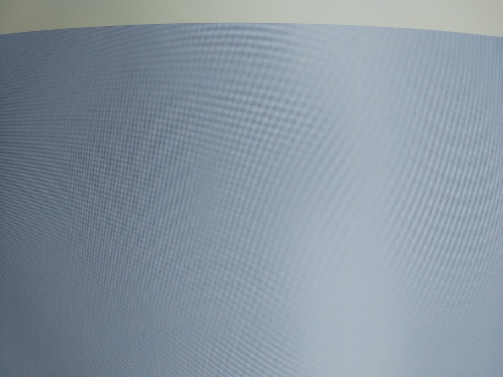

R rıza keskin Member Jan 6, 2018 #2 I add one more sample image. Attachments photo7250.jpg 240.2 KB · Views: 376
G georgev Member Jan 10, 2018 #3 rıza keskin said: Hello. I can not get the lines out of the mold. What should I do? Click to expand... Do you have black lines on a positive plate? The lines have the same distance?

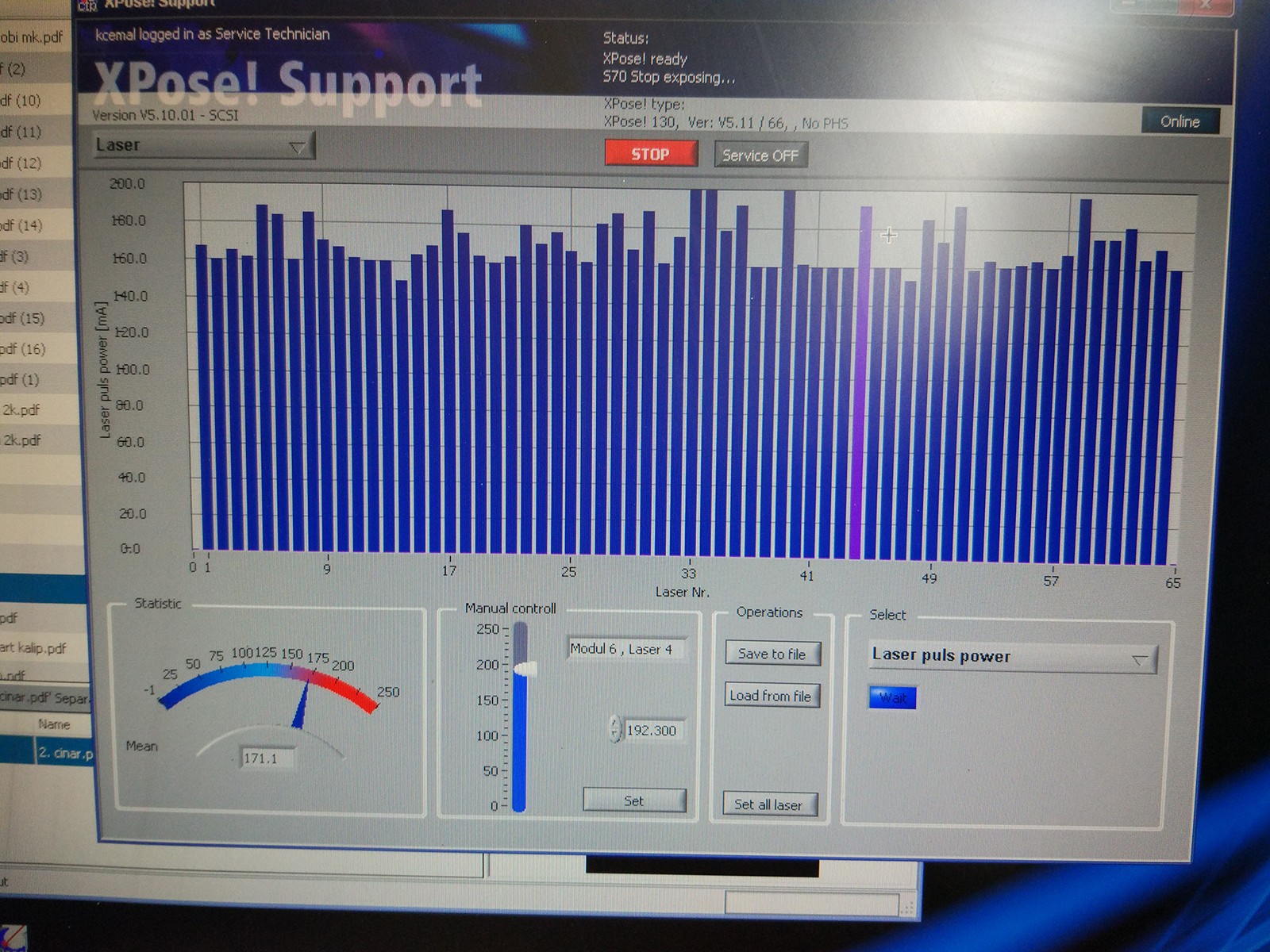

C ChrisZ Well-known member Jan 15, 2018 #4 Show laser tab screenshot from support tool. Is focus set OK? Chris
R rıza keskin Member Feb 2, 2018 #5 laser screenshot laser 60 - drum 460 Attachments photo7307.jpg 500.6 KB · Views: 381
C ChrisZ Well-known member Feb 5, 2018 #6 Expose using lasers 1-31 and report back image quality. Chris

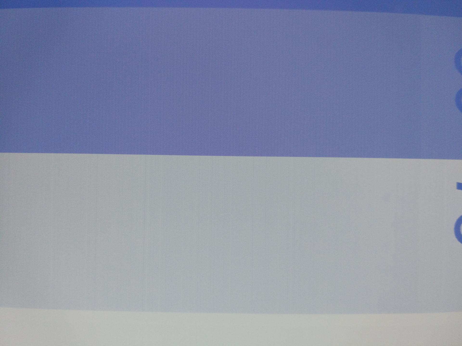

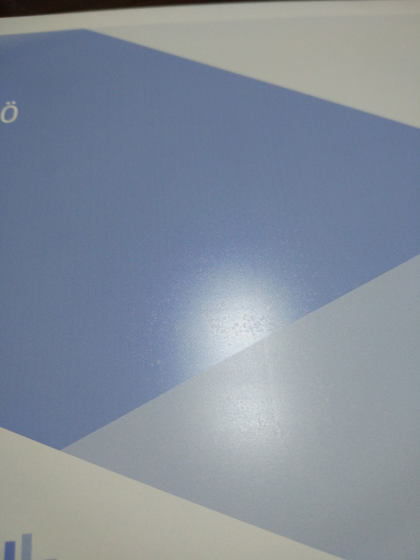

R rıza keskin Member Feb 5, 2018 #7 lasers 1-31 image quality Attachments photo7311.jpg 308.1 KB · Views: 358
