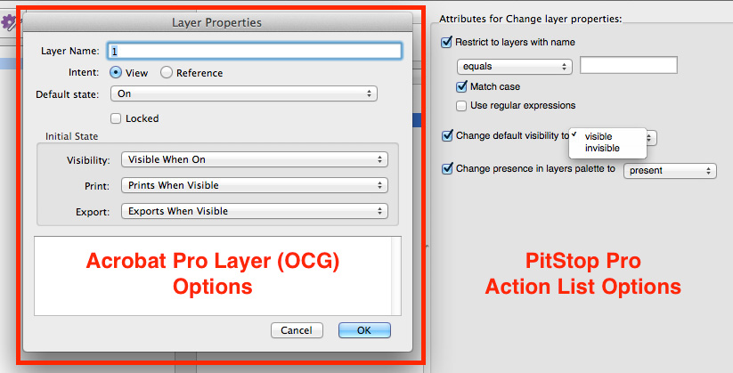

The image attachment compares what is available in Acrobat Pro to PitStop Pro.

I searched and read up on OCG (layers) and went through some of the technical documentation on some other workflows. In all fairness the "printable/not-printable" feature is being ignored printing industry wide as far as I can tell. Adobe is also ignoring this with their Creative Suite apps (except Acrobat) as far as I can tell. There are other industries using this "printable/not-printable" layer feature but the printing industry isn't?
A little history:
This feature has been around since PDF 1.5 (Acrobat 6) which was released in 2003. OCG (layers) is even supported by PDF/X4 adopted in 2008 (ISO 15930-7). Which is based on PDF1.6.
As someone with some background in user interface design and user experience (ui / ux) I can understand how novice users could become extremely confused by things that are visible yet not printable. However, that does not mean that advanced users should be neglected nor that users should not be trained and empowered. Some will likely assume if it isn't being supported and isn't being clamored for that it probably isn't very useful.
