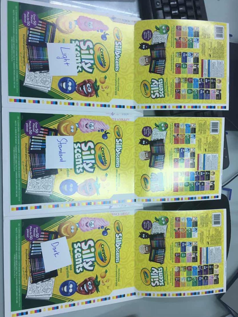

Dear all,
I'm new member. I need advice from all of you the way to making standard book with Light - Standard - Dark.
The current method I'm doing is using tolerance of density reference with GRACoL page 21, Section 6.2 - Calibrating, Printing and Proofing
Cyan 1.45+/-0.1
Magenta 1.45+/-0.1
Yellow 1.0+/-0.07
Black 1.7+0.2-0.05
I will making the standark tone first, then record density of all inks.
Second reduce (-0.1) density of all ink compare with standard --> light tone
Finally increase (+0.1) density of all ink compare with standard --> dark tone
So, I need get advice from all of you, If you have any method to do better.
Thanks all

What is the point of what you're doing?
Finding the best way to making color standard with light - Standard - Drak tone for production

Hello Thaiha,
We used to use colour standards a lot. We try to avoid it now.
Let us see if I have understood you correctly. You have this four colour job. You want to print a colour standard for your own reference.
One colour standard will be the lightest acceptable print.
One colour standard will be the darkest acceptable print.
I have some questions for you:
Will these colour standard sheets be used just in your print shop or will they be sent to other print shops or clients?
Will people just be using their eyes to look at these colour standards to decide if the print colour is acceptable?
You have a Densitometer. Do you also have a Spectrophotometer?
What kind of press are you using?
Dear Tim-Ellis,
Pls see my reply below:
Will these colour standard sheets be used just in your print shop or will they be sent to other print shops or clients? --> Thaiha: These colour standard sheets will be use for our print shop and clients also.
Will people just be using their eyes to look at these colour standards to decide if the print colour is acceptable? --> Thaiha: People use their eyes then use Spectrophotometer to measure density and Delta E for reference.
You have a Densitometer. Do you also have a Spectrophotometer? -->Thaiha: We have Desitometer and Spectrophotometer also.
What kind of press are you using? --> Thaiha: We have 3 Komori (6 color units + 1 coating unit), 3 Komori ( only 2 color unit), 1 KBA (7 color + 2 coating unit) and 1 Roland (6 color unit + 1 coating unit)
Yes, you are correct Tim-Ellis.
We always print not only 4 color but also to 7, some time to 9 color.
C, M, Y, K and some spot colours
We stay well away from doing 4 colour CMYK process lights/Darks as the process never follows what we would produce on press. For instance you will simulate on your standards all colours going up say 5 points in density where as on the press only the magenta may go up 5 points but the yellow or cyan may go down 5 points, you cannot simulate this in your lights/darks as the combinations would be endless. example. cyan up magenta up yellow down. We have not even covered the effect of dot gain and how it could affect process colour lights/darks.
We do lights/darks only for the special colours and we have around 2000 at the moment. Some are sent to the customer at their request and some are only used inhouse to make good/no good decisions.
We concentrate on reducing as much as possible the causes of variation and conduct regular process capability studies on our presses to check they are performing within our tolerance.
We have a great ink inplant and we verify their inks match using Spectro on press so we know we are starting off with the correct colour.
Not saying this is perfect but it is what we do and so far it has worked for us.
Good luck
