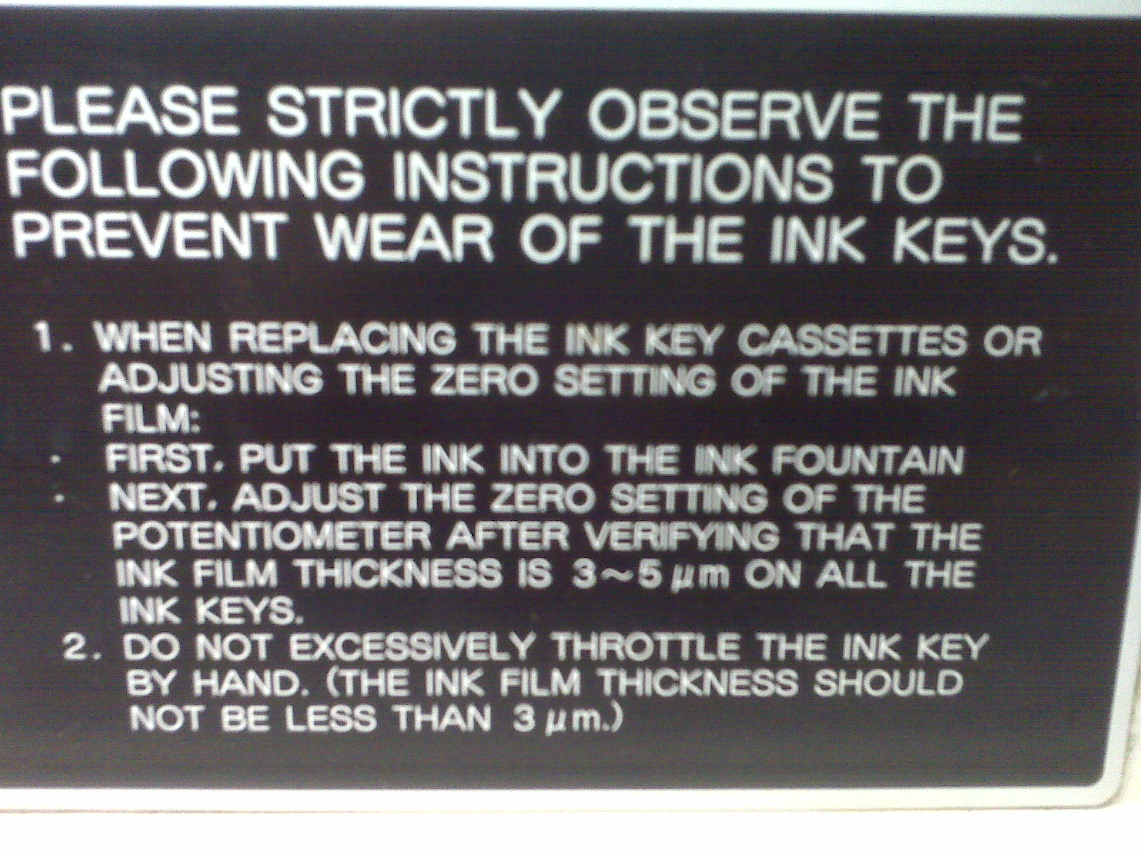

With A Mitsubishi they recommend 3 to 5 microns. They feel it will hold a better zero set.
An ink film thickness gauge is supplied with every Mitsubishi press. The attached pdf is a page out of the parts book showing the gauge; part number for this gauge is KA32315. If the gauge is missing MLP U.S.A.,Inc. sells the gauge for $483.00.
The attached picture shows a plaque which should be installed on the machine telling you the ink film thichness should be set between 3~5 microns.
The visual method is ok as long as your eye can detect 3~5 microns, you need to be cautious though as 3 microns of black on the fountain roller looks much different that 3 microns of cyan.

When your Mitsubishi 1F was new in the tool box there is a tool for measuring the ink film thickness.
If you look in the operation/maintenance manual it shows you this.
