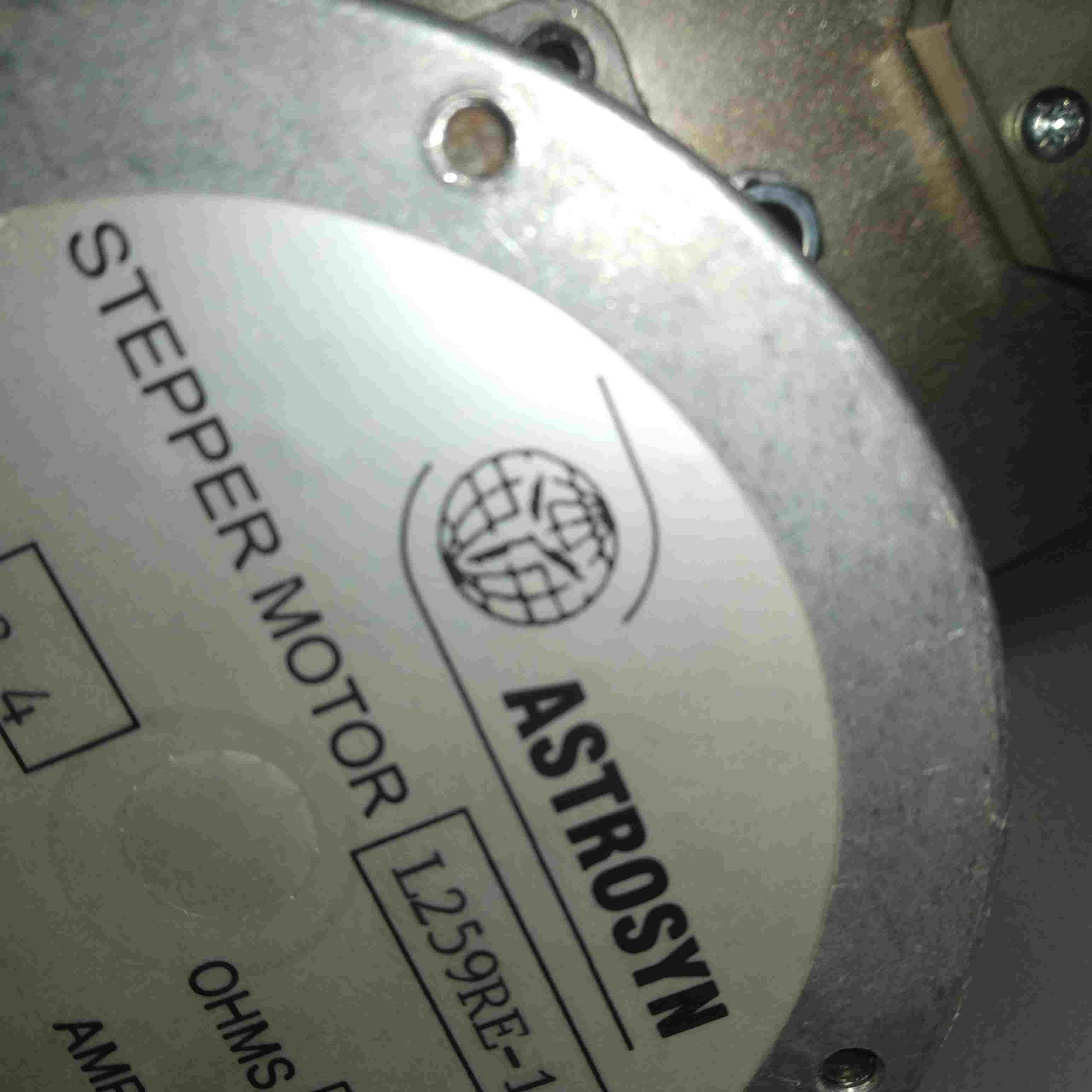

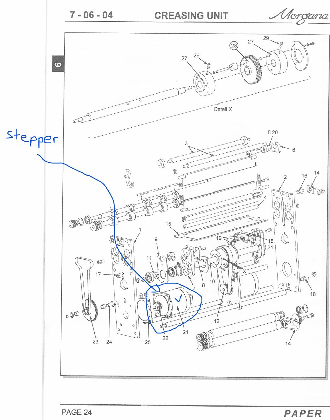

Hi there.
According to Morgana this is an obsolete model. No parts:-( My only hope is finding a second hand one somewhere.
If you are in New Zealand or Australia happy to purchase whole machine (at the right price).
Not likely but just thought I'd put it out there. Thanks for looking. Simon

Skip Morgana and go directly to the manufacture, Astrosyn. If they don't have a replacement ask for the technical specifications of the motor and search online with those specifications. You will also find some companies that will repair motors, maybe not in your area or country but they are out there, Google will find them.
Years ago I had to do exactly this for a Mitsubishi plate maker that needed a new motor. I ordered it directly from the manufacturer that was in Japan. It did take a while but it worked like a charm.
Excellent advice. 9 out of 10 times I can find the component I need online (usually less expensive and sometimes quicker) instead of going to the OEM. I have run into some components that have been made specifically for the OEM, but it's rare.
One you have pulled the motor out, upload a photo of the specs / what it looks like. Might be able to find one from a different manufacturer
