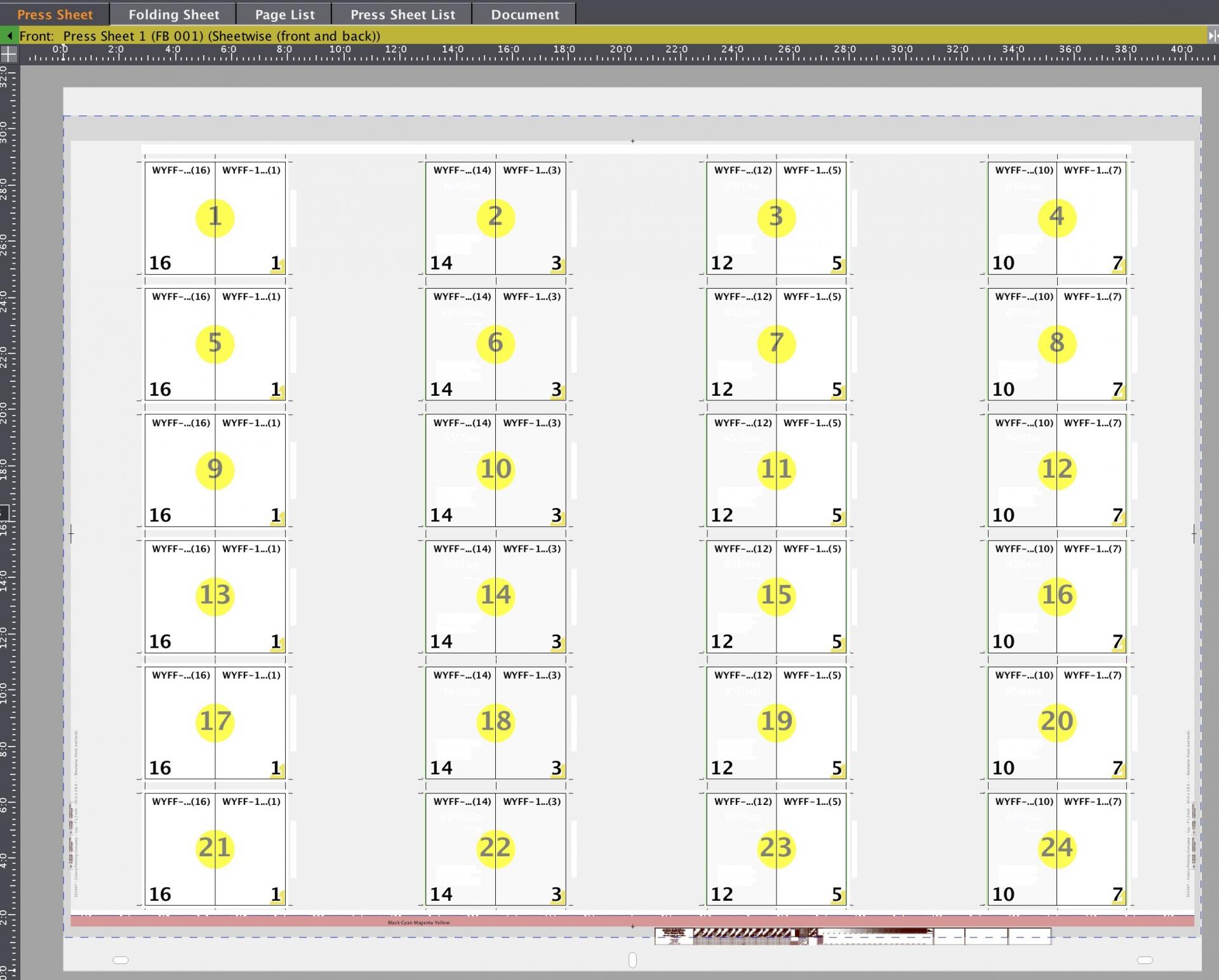

I have 6 small 2.5" x 4" 16pp booklets that need to all go on one Press form 40 x 28 sheet. Since they are printing on cover stock, they have to be layed out as 4-4pp schemes. Attached is how the booklets will lay out. Book A will be in the top row and go left to right, Book B will go in the second row down from left to right, etc.
How do you isolate each 16pp book so it can contain its own creep and pages. If you start with 96pp count (16pp x 6 books), it would treat the layout as one big 96 page book. If you create 6 "Parts", each with 16pp, each part goes on their own plates rather than all 6 books on one plate. I can upload the Signa JDF or a Signa export if it helps.

I found a video where the operator created several Saddle Stitch "Parts" in which he DID NOT assign any plates. He then created a last part WITH a Plate assigned to it. He then dragged over the folding schemes from Parts 1 and Part 2 into the plate Layout in Part 3. It worked in my job.
FYI, the video is here: https://www.youtube.com/watch?v=JGmKpBZJT70
