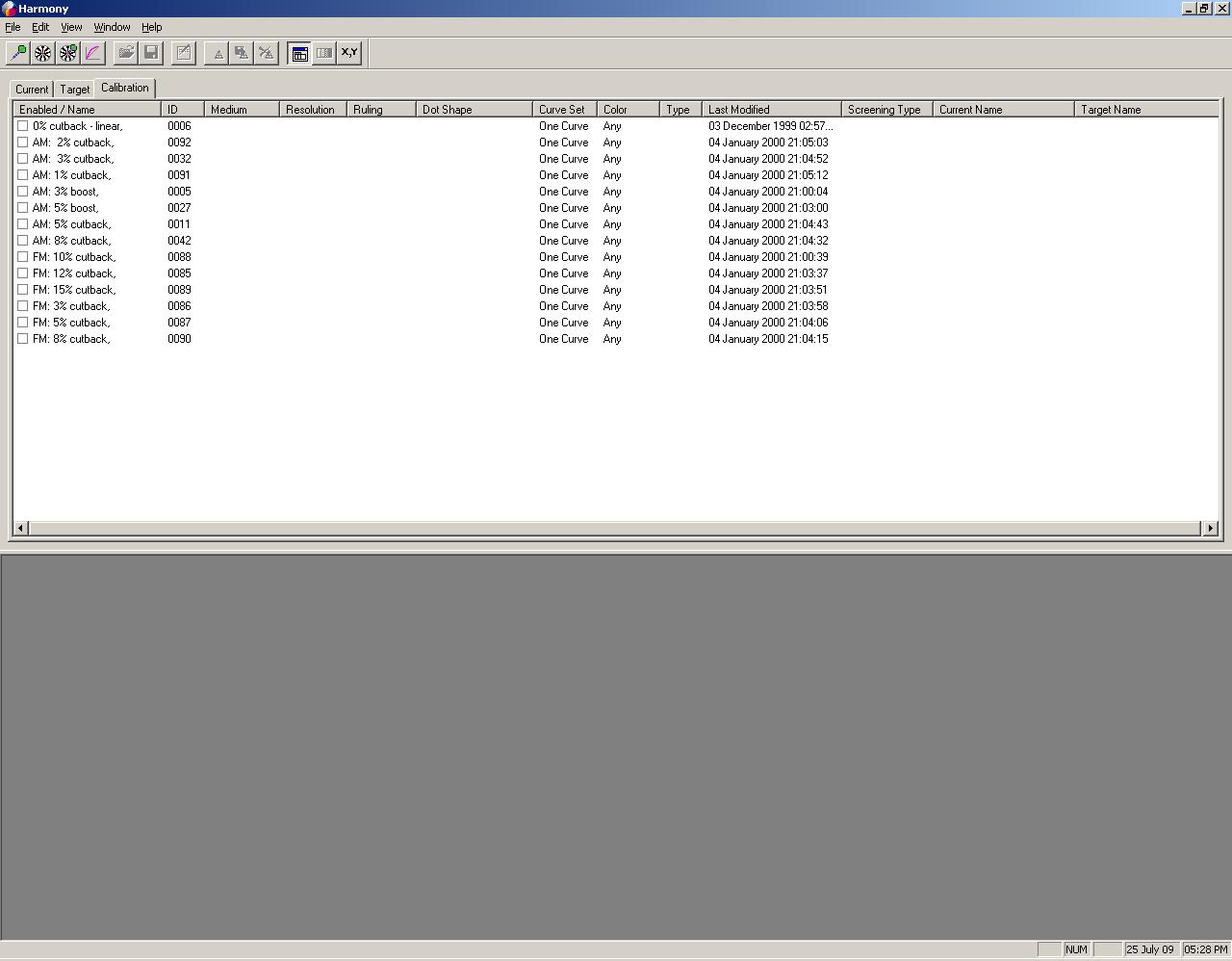

We needs calibration curve for staccato to compensate dot gain. We uses Prinergy Connect Workflow 4.1 and stoccato 36 for newsprint, paper 42 g/m2, ink Flint. Can we uses standard curve, where we can find it?

Use Harmony Software from installation disk.
Of course you need test print.
Also, you can try curves from https://ecentral.kodak.com.
See attach
(after download change extension from txt to hmy)
