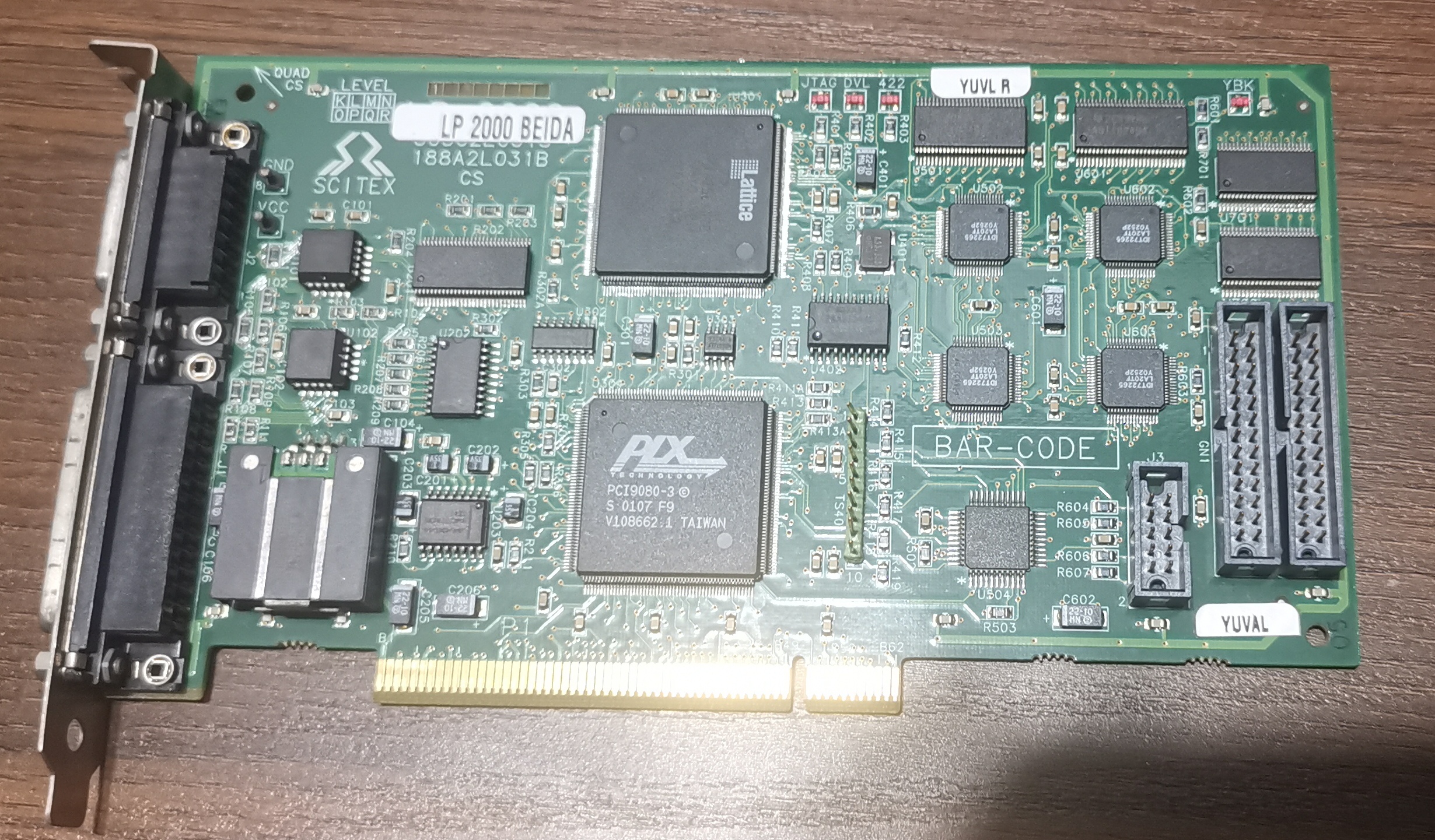

I just purchased a card for Dolev 800 V3 as title, but I don't have the driver for the card, and the seller and many other that I reached out also don't have the driver as well. Could anyone share the driver of the card with me if you have it?

I am not familiar with this board, the Dolev 800V3 Ebox I have contains different boards.
Please enlighten me, what is the function of this board?
I think it's just a RIP card. My main RIP card has IC on the board and it keeps dying every few days lately. This one doesn't have any IC so I'm using it to test if I can replace my main RIP.
The Scitex RIP is software, not hardware.
The latest versions run on a Unix workstation/server (BRISQUE) that sends the bitmapped imaging data via the TSP card/cable to the Dolevs' Electronics Box.
Try peeking under the BEIDA sticker and see what is written on the PCB.
BTW, on which card is the IC you refer to located?
I suspect it is on the SBC (Single Board Computer).
Perhaps you can describe your Dolev Startup sequence.
I agree with you that Scitex Rip is just software. Our machine's BRISQUE actually died a long time ago so the machine now functions using Xitron Navigator RIP. At the moment, the card PCIE lane is bugged so I'm temporary using compose card, which I don't really like. I know that this Beida card is compatible so I am looking for the driver of the card for Windows 7/10 to run it with Navigator RIP software like the compose card I'm using.
I gather that this LP 2000 Beida card is not going to replaces a card in the Dolev.
Xitron/Compose cards reside inside their specific external interconnection box.
Seems strange that a Scitex card will fit that system, do you actually know anyone using this card?
