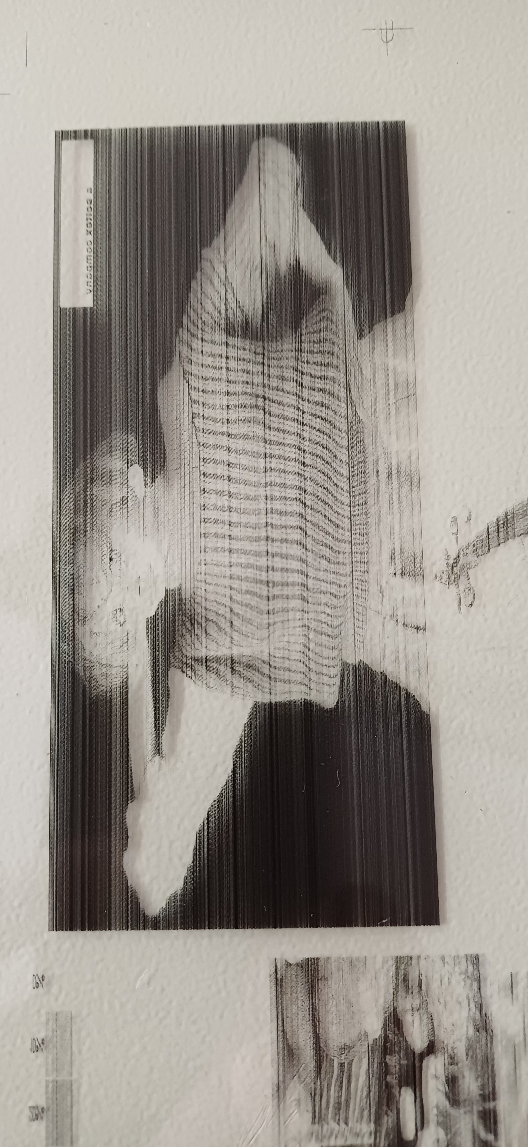

I work for a company that uses a Dolev 800. We recently moved it. Since then, we’ve been experiencing a flashing issue: the files come out distorted and full of streaks (see photo 1). We don’t understand why.

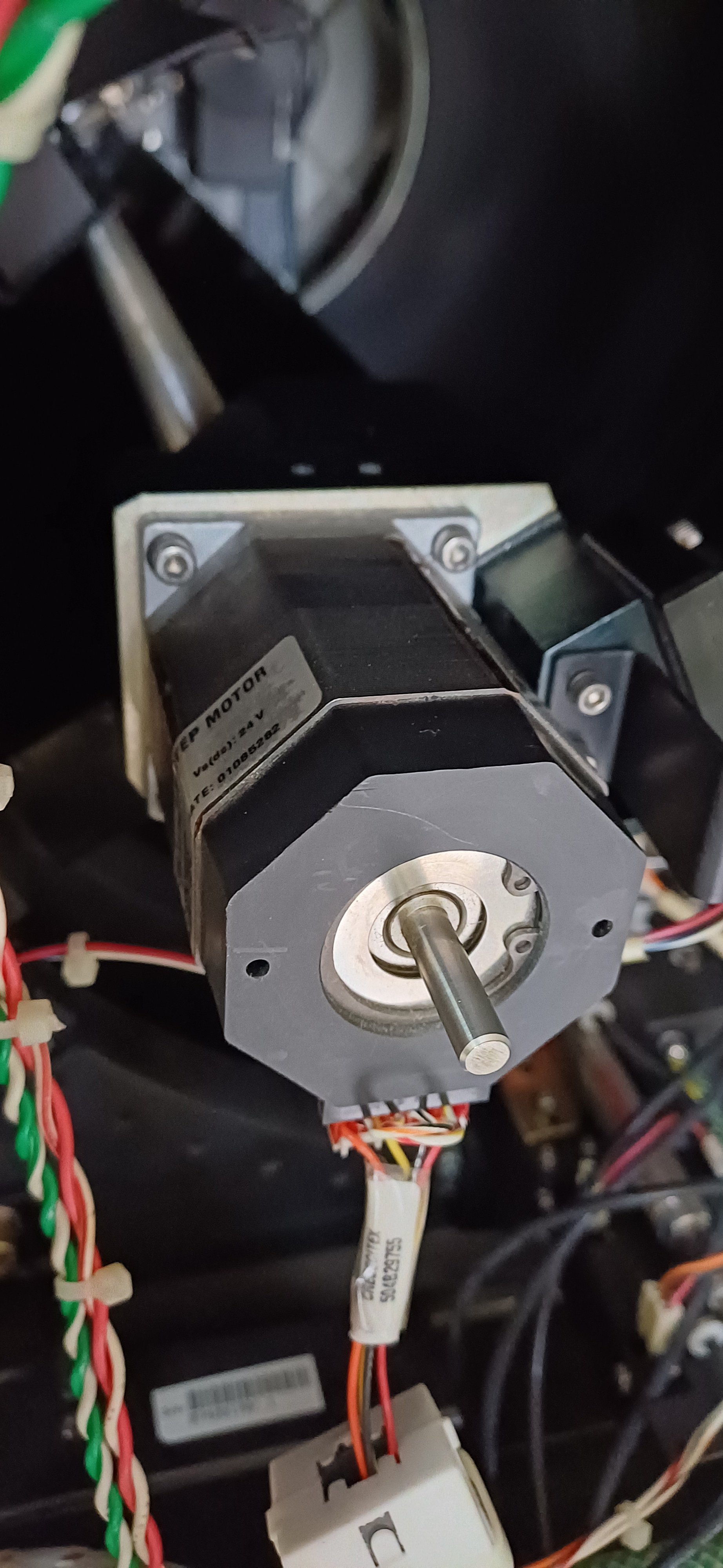

Additionally, the rotor is overheating (photo 2). It doesn’t seem to be functioning properly. This could be the cause of the distortion and streaks on the films.

Such distorted images are usually caused by film not being held flat by vacuum during the actual exposure.
Try exposing a sheet of film while the covers are open and watch the carriage run.
Watch if all movements are smooth with no obstruction or interferences.

Hello,
Thanks, I’ll try that and see… but the fact that the engine is overheating—what could be causing that?

The motor over-heating probably indicates it is working too hard pushing the carriage.
Perhaps there is an obstacle on the track?
Or, the track may need cleaning and lubrication (with thin Silicone Oil).
It may also indicate that the motor is at the end of its' life, but I think it is unlikely.
Did you verify that the vacuum is holding the film flat during exposure?
We turn on the Dolev… let it go through its cycle. Once it finishes the different steps and displays “Ready,” that’s when the motor starts heating up and becomes extremely hot—even though it has no files to process and isn’t even working. We had the motor checked, and we were told it’s not defective at all… :-(

The punch units are located on the Right Hand Side of the drum and if they are not in the "out" position they may interfere with film and create problems such as the distorted image you had.

What’s concerning is the motor we just turned back on—it becomes burning hot after just 5 minutes. And it emits a slight high-pitched noise.

Concerning the Lead Screw motor that is heating up, do you have a spare motor and a spare Driver Board for troubleshooting?
In case you need any part, I have plenty of used Dolev 800 parts I kept from my older Dolevs.
Can you come and fix it for us??? :) Just kidding…
We do actually have a spare motor, which we swapped in, but the same thing happens with both.

Concerning the motor Driver Board - you can find it at the upper section of the Electronics Crate that is located at the lower Right Hand Side of the Dolev.
