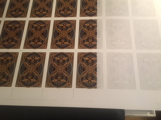

I'm having an issue where the page pints perfectly 3/4 then the rest of the way the image fades away. This is on the OKI c931 printer. I'm not sure why it's doing this. Other paper stock it works fine but this one wants to act up. It's a card stock but I have ran thicker card stock through this machine. Any help or suggestions would be greatly appreciated.

run the file on different stock and see if it prints ok. that rules out file issues.
I would guess the grain is wrong. run it the other direction cut in half if you have to and show us the results.
